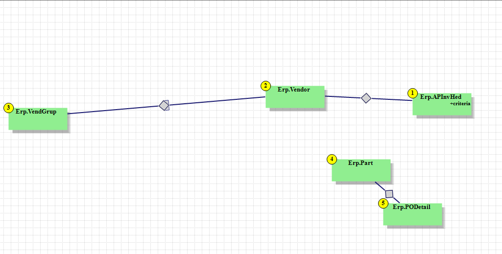

Hello,
I have a BAQ where I want to add Part and PODetail. I am having trouble connecting these. I know I need Table Relations but can’t find a second one outside of Company that matches.

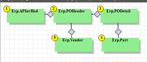

Add POHeader (which has VendorNum and PONum keys) between Vendor and PODetail.
You might (not necessarily, but it’s worth thinking about) join APInvHed to one of the PO tables to reduce duplication. That’s not an automatic decision since you can have an invoice without a PO, so joining it to the PO instead of the vender will filter out those misc. invoices.

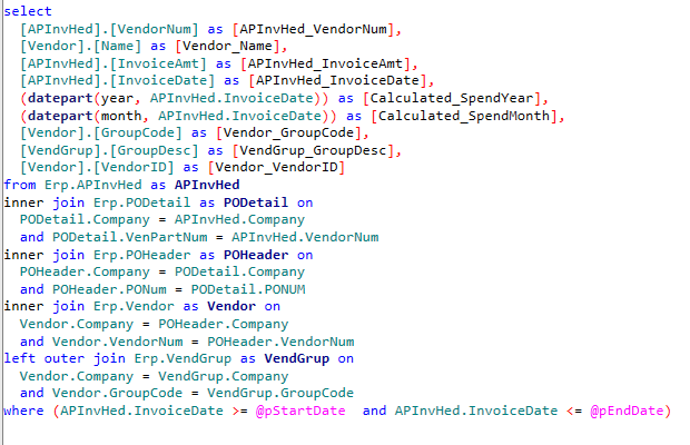

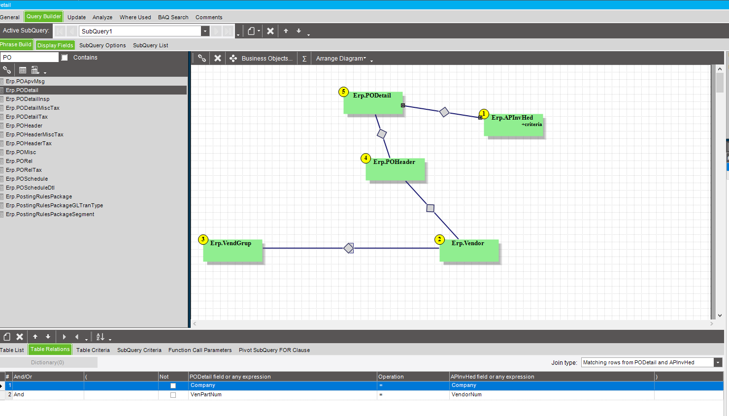

This is what I did but it gives me: “Severity: Error, Text: Bad SQL statement.”
It looks like your join from APInvHed to PODetail is your issue.
You have VenPartNum = Vendor number
Switch the position of POHeader and PODetail and then link APInvHed to POHeader with Company and VendorNum
Then you can link Part to PODetail and link Vendor to POHeader
Your joins you will need to figure out but this should link and work everything you are looking for.

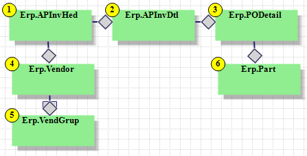

Alternate option: include AP InvDtl. You might even be able to drop PODetail entirely. Depends on what you’re looking for specifically.
Thank you both!
Well I ran into an issue. Apparently it’s doubling up on some of the content. Like repeated lines of the same information.

inner join Erp.APInvDtl as APInvDtl on
	APInvDtl.Company = APInvHed.Company
	and APInvDtl.VendorNum = APInvHed.VendorNum
	and APInvDtl.InvoiceNum = APInvHed.InvoiceNum
inner join Erp.PODetail as PODetail on
	APInvDtl.Company = PODetail.Company
	and APInvDtl.PONum = PODetail.PONUM
	and APInvDtl.POLine = PODetail.POLine
inner join Erp.Part as Part on
	Part.Company = PODetail.Company
	and Part.PartNum = PODetail.PartNum
