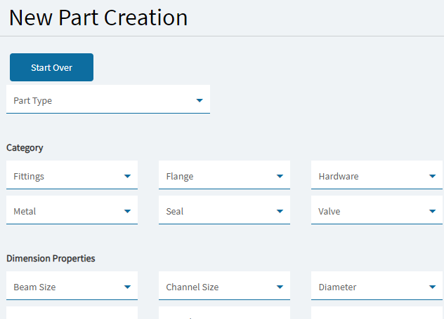

This is what the slider looks like now.
As you can see, every possible field has it’s own drop down now. I believe I have around 39 combo boxes on the page now. All but 5 of the fields has it’s own User Code behind it.

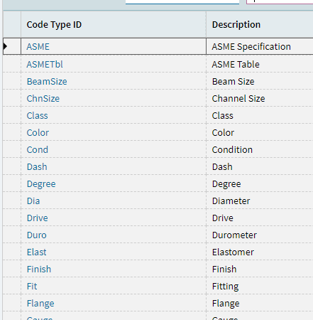

Here is a screen shot of the User Codes.

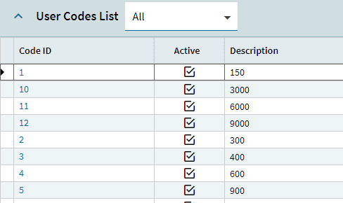

Here is a screen shot of the list of values behind the Class code.
I added 4 fields to the UserCode table to store a couple of check boxes that I am using for filtering, a column used for sorting the values in the drop down, and a field for the value to be used in the part description (I had not noticed the Full Description column until after I added my own. :man_shrugging: :man_facepalming:)
The original method was very restrictive, if I did not have a group defined for something, the user would never be able to select a value. Now, it is much more reliant on the user to select the correct things. There is nothing stopping them from selecting a value in every field, which is not correct. But I can give access to User Codes to a few people so that when they come across a value that is missing, they can add it them selves. Also, it will be much easier to add a new drop down if needed.
