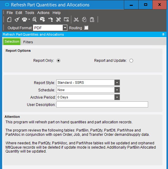

There is a conversion to update the demands on the PartWhse/PartBin tables.
I misspoke. It is a program in the menu:
