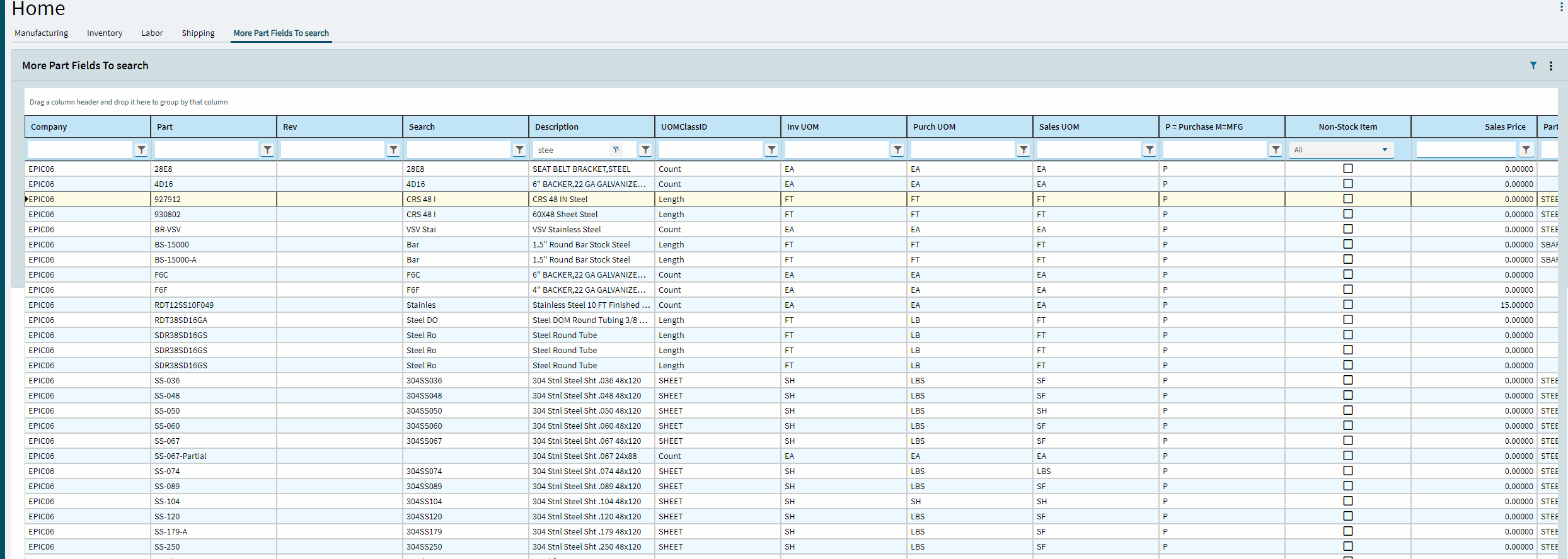

I just created a Tab on my home page with a baq grid. I just made a baq with all the part info I could possibly want to filter by and can right click on the part number to open it in part entry. In my opinion it allows the best of both worlds. If I know the part number I can just go to part entry and enter it. If I need to find a part I can use my baq grid to filter and right click and open it.
PartSearch1
Here is it filtering in demo db.
PartSearch2
Here is an example of the fields I included
Might be able to do a most-recently-modified BAQ in there too… :thinking:

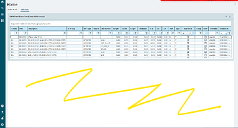

I like this idea… for various reasons… but when I added a BAQ grid widget to a tab, it won’t expand… Is there a trick to that? It only fills about 1/3 of the page and is pretty unusable like that.
In our current live when I first open it, it is expanded but the second I refresh it I lose the expansion. I am guessing it is a bug, that is the one negative. I just refresh my browser tab instead of the baq and it is back to full screen.

Try this setting on your grid so it will expand to fill its container:

This is a Home page widget… I don’t have access to App Studio to change settings.
