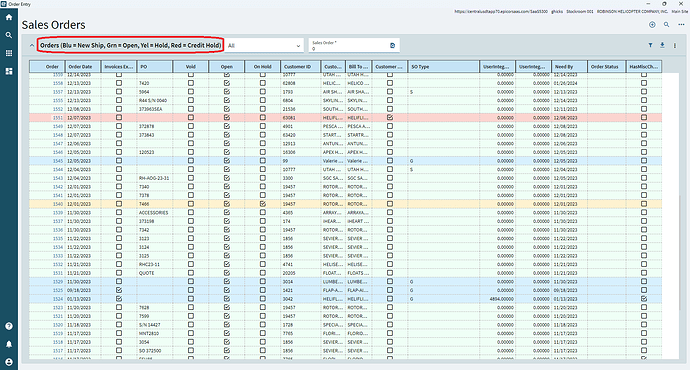

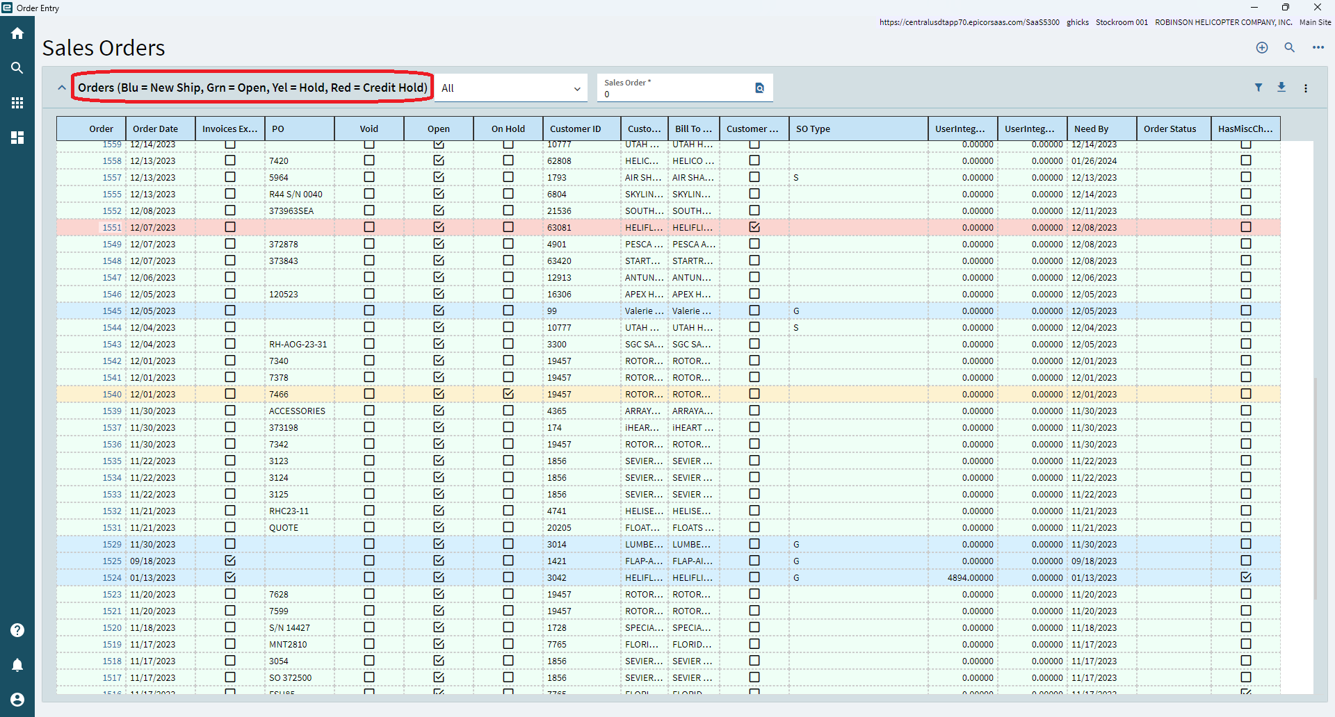

Agree that it is annoying in places, but others it is helpful to find “At-A-Glance” details. We do use it on Parts, but not the end of the world if it is not there. I would think a user Option under Personalization to turn it on or off at their preference would be nice. Also there is an Idea to add more colors.
Example of Sales Order Landing Page.
