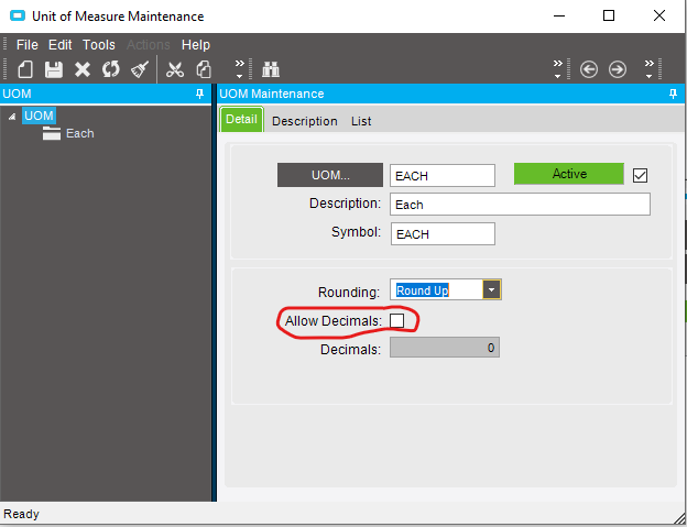

I’m attempting to DMT part records from one environment to another. One error I receive on a couple part records is “Table: Part Msg: Track Serial Numbers cannot be turned ON, the part Sales UOM allows decimals.”.
However, the SalesUM field on my DMT template is set to EACH, which doesn’t allow for decimals:
I tried removing the SalesUM column from the template completely, but this didn’t resolve the issue either.
It’s not all of my parts, I’ve broken out the Part DMT into several parts of about 10k records each. I received this error on 205 records on this first DMT template. I haven’t ran the others through yet.
Good to know! I’ll investigate this on the errored records.
You’re saying, drop the S/N columns from the template and set the part UOM to EACH, then run an update DMT enabling S/N?
Gotcha… sorry I was pulled away from this but I’m back now. That makes sense. Oddly, I’m using the same part classes in both the old and new environment, but I don’t receive this error if I mess with SUM on Part Entry. Regardless, you have been extremely helpful. Thank you so much for your time!
