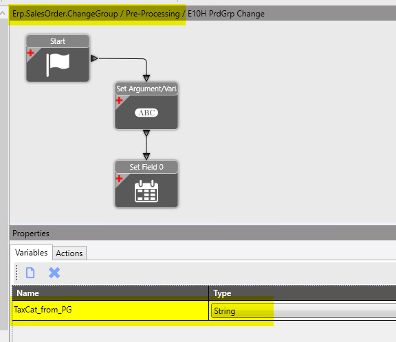

Pre-Proc on SalesOrder.ChangeGroup
Make a variable (like shown above) to hold the TaxCatID from the PG
In the Set Argument/Variable widget, set the variable you made with the expression:

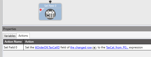

Then use a Set Field widget to update the TaxCatID in the temp table
The expression is just TaxCat_from_PG (the variable you created)
And it automatically updates the TaxCat in the UI.

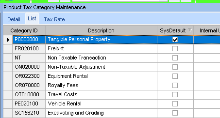

Double check the Prod Tax Category screen. Use the List view and sort by “SysDefault”
Odd. Mine are all blank.
Here’s what I see:
  • With a Product Tax Cat set as the default, making a new line in order entry creates the “empty” line record, but Tax Cat is automatically selected.
  • With no Product Tax Cat set as the default, making a new line in order entry creates the “empty” line record, and the Tax Cat is blank.
Yes, I see that too.

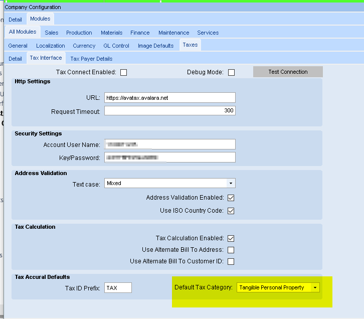

However, once I type in some random part number (e.g. abcde), the tax cat gets set. I’m wondering if there is some random BPM running that I can’t find.
When you type in a part on the fly number and hit tab, does your tax cat stay blank (when none is set as default)?
Yes. After entering a POTF P/N and hitting tab, my Tax Cat is still blank.
I poked around in Copmany Configuration and didn’t see any settings for default tax cat.
FWIW - we have TaxConnect by Avalara, and that might be the difference we’re seeing.
Thanks. We’re also on Avalara.
I’ll keep looking to figure out why hitting tab sets a Tax Cat.
Thank you, again.
maybe here …
Tax connect is turned off in my test environment. maybe thats why this wasnt being applied
Yup! That’s it. Thank you, so much!
