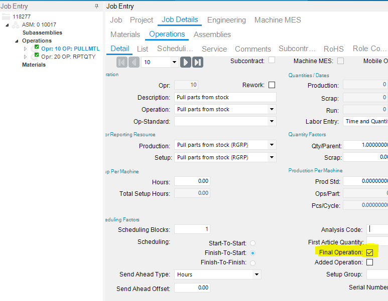

But check on what is the FINAL operation.
Not what you THINK is the final but what is actually checked off as final.
Do you have a BPM in place to not allow operations to be completed before prior operations are completed?
