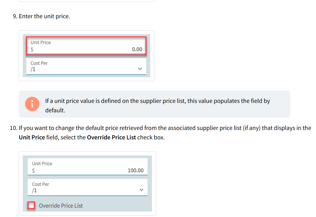

Helptext doesn’t seem to imply any options…it’s either the supplier price list or it’s zero.

Here’s a thread on topic from the E10 section…reads like it’s Supplier Price List as default value…if not found, checks last PO price for that supplier/part…else 0.

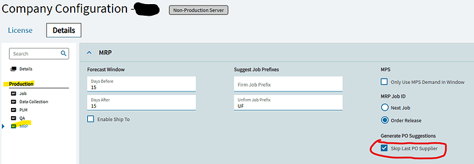

This setting in Company Configuration may impact if a last price gets pulled or not for PO Suggestions:
