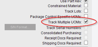

vantage had an older concept for tracking stock in multiple Dimensions at once, but it was done differently than it is now.
In E10, we store the dimension (UOM) directly in the PartBin, and do the conversion to the base stocking UOM. I hadn’t noticed that the table was still there, but it is probably there for historical reasons. If you check the “track Multiple UOMs” it has different behavior when storing inventory.

We use both track lots and Multiple UOMs.
