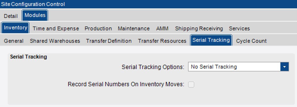

You will need to make sure you have Serial Tracking enabled in Site Configuration. I believe it is turned off by default.
Outbound will only prompt for Serial Numbers when shipping a completed Serialized part or receiving it to inventory.
Full will prompt for Serial Number during many different transactions throughout the production process.
