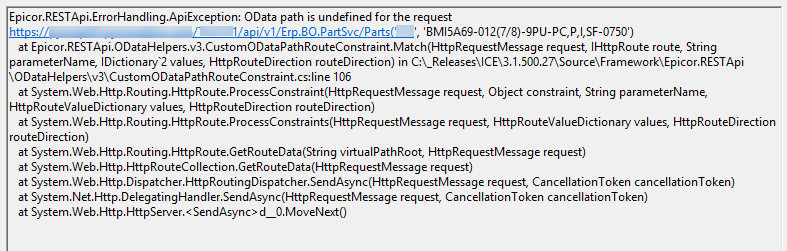

Im reviewing our epicor application logs and have noticed something. In one of our programs we are searching for a part number, but some of our part numbers contain parentheses. The log says OData path is undefined. Can REST handle parentheses, comma’s, and slashes? Any ideas on how I can resolve this issue? Do I need to use encoding or something?

That did not work. I think thats just part of the issue. This is a sample of some of our part strings.
BMI5A69-012(7/8)-9PU-PC,P,I,SF-0750
Our part can contain
– , ( ) / \ and °
David
I have tried encoding the entire string
BMI5A69-012(7/8)-9PU-PC,P,I,SF-0560
to
BMI5A69-012%287%2F8%29-9PU-PC%2CP%2CI%2CSF-0560
with the same results. I wondering if I need @Bart_Elia expertise to resolve this issue.

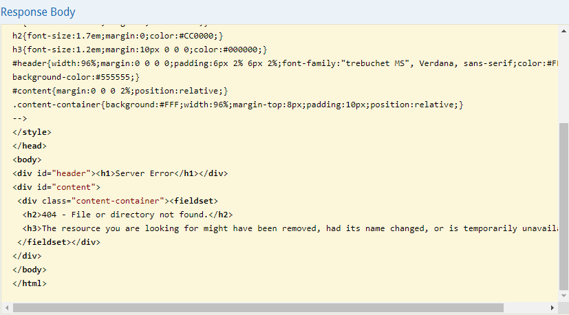

I cant get the encoding to work in PostMan or the Browser. This also is driving me crazy.

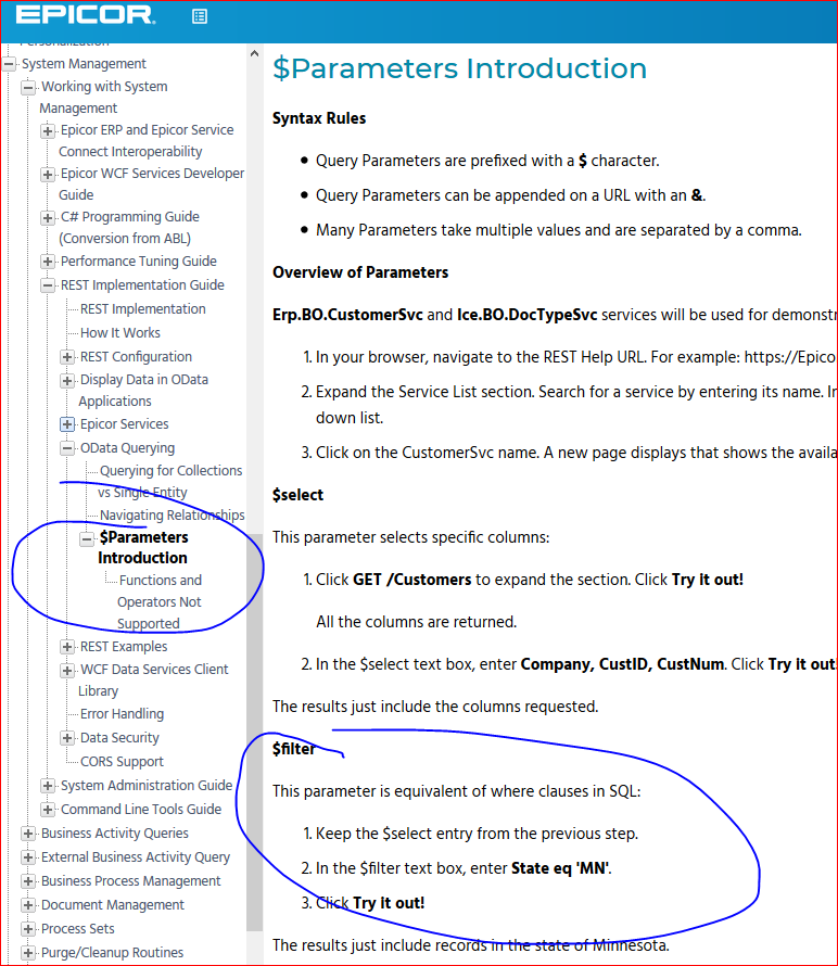

Try using $filter instead of () in the request path
I am not on this project anymore so my knowledge is fading gradually :slight_smile:
I agree with Olga - If you go to your help on REST you will see a blurb on the Filter $parameter from the OData spec:
<…> HelpERP/enu/Standard/snm_enu.htm#REST/RESTODataParamIntro.html
This would change your url to something like:
<…>api/v1/Erp.BO.PartSvc.Parts?%24filter=Part%20eq%20‘thepartnumber’
That should be easily testable in the swagger page
Lastly, get a ticket open on this please.
I am able to use the \Parts call with the filter and get the data I need. @Bart_Elia I will open a call today.
