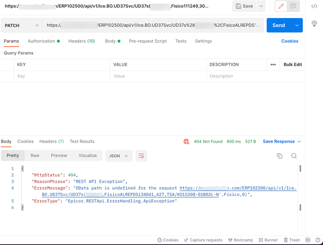

I Need patch rows externally for UD table, The trouble is when the partnum have a ‘/’ I get this request.
“HttpStatus”: 404,
“ReasonPhrase”: “REST API Exception”,
“ErrorMessage”: “OData path is undefined for the request”
No Problem with this part when I call GET method.
https://myserver.com/ERP102500/api/v1/Ice.BO.UD37Svc/UD37s(COMPANY,FisicoALREPDS134041,427,TSA/KO15208-01B02L-N’,Fisico,0)
can any one help me?

Hi @Aaron_Moreng same error in Postman with url encode
https://myseecer.com/ERP102500/api/v1/Ice.BO.UD37Svc/UD37s(COMPANY%2CFisicoALREPDS134041%2C427%2CTSA%2FKO15208-01B02L-N'%2CFisico%2C0)
