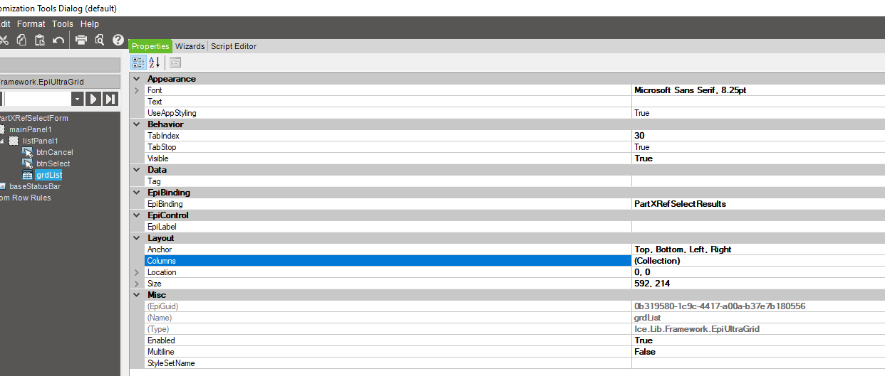

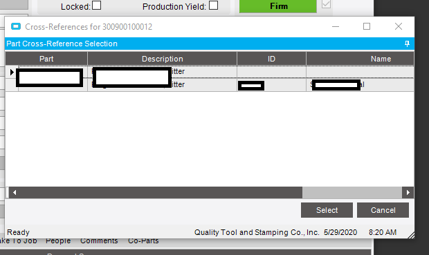

I would like to customize the selection grid for PartXRef to also include the revision. Right now it looks like this:
2
In developer mode, I see that the binding of the grid is “PartXRef Selected Results.”
Is there a system query that I can access to see if I have the option to bring additional columns into the selection grid? I browsed a lot of “z_” queries but couldn’t find anything.

When you trace the transaction, does it show it calling a baq or directly calling the BO reader?
If I had to guess, this is most likely a hardcoded, compiled on-the-fly query in the source code.
Thank you. But Yuck. Looks like I will have to bark up a new tree.
As I expected, it is hardcoded in the BO itself (code removed as it isnt helpful).
You might be able to still use a FKV to link and pull some additional data
So in this trace packet, there is reference to a Erp.Tablesets.PartXRefSelectTableset. Is this tableset a SQL view or does it live as an accessible entity within Epicor. From your response, I imagine this is not something I can customize, but for my own understanding…
