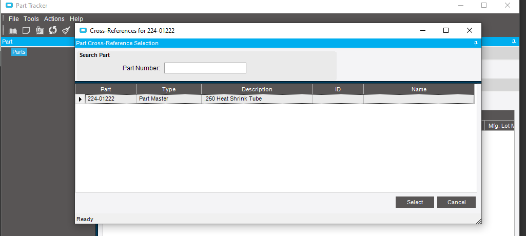

Part Cross Ref Pop-Up with only 1 record
In Part Tracker i have a part when it is entered launches the part cross reference selection pop-up window.
Fine we have plenty of parts with various cross references.
But for this one there is only one record in the results window of the pop-up and it is of the Part Master type.
Any ideas?

It is just strange that the only record returned is a type Part Master.
Is it strange that in the window the record doesn’t have a value for ID or Name? or is that because the type is Part Master.

The problem is the fact the pop up is happening and the only record is the same value as what is entered into the PartNum field. So you have to then select the record with the same partnum value. So it is 2 more clicks.
This seems to be an isolated issue at this point. The business hasn’t come forward with any other instances of superfluous cross reference selection pop ups.
