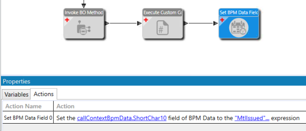

I’m wanting to refresh the dashboard when I hit the update on the BAQ (advanced update). So, in the BAQ update I set callContextBpmData.ShorChar10 when the routine finishes.
In the dashboard customization I check this field when the dataset initializes, but it never shows any contents.
Is it possible to do this?

What I’m looking for goes the other direction. I need the BPM in the updatable dashboard to report back to the customization that it has taken an action. I can set the field in the BPM, but the contents don’t make it back to the customization when the update is finished.
I thought there might be an update of the callContextBpmData record available in the BPM but haven’t found one.
Joe
