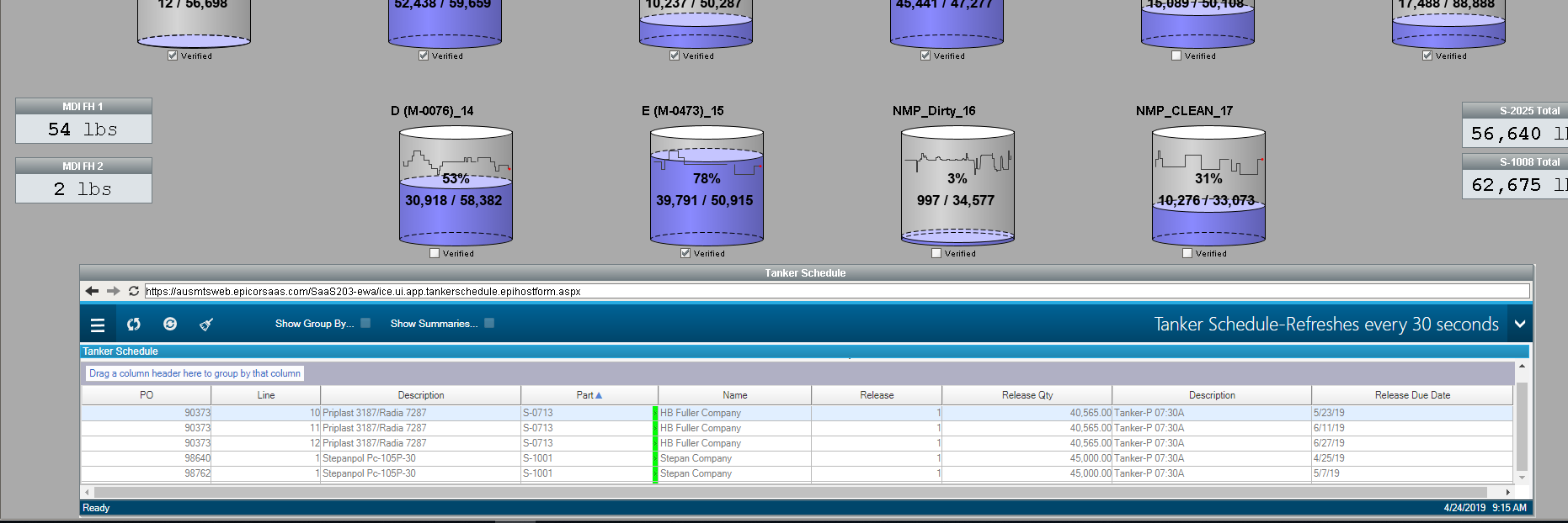

I have a webform dashboard that i what to pop up without having to enter a username and password. Is there a way to pass the epicor credentials through the URL of the webform?

Trying to embed Epicor data into a program (Ignition) by means of a web page.

It brings me to an epicor login page before the data shows up.
