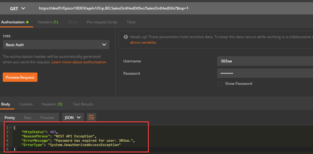

Each time I pass the username and credentials into Postman to make a call, I am returning this error:
As a workaround, I go into the user account maintenance and I click “Expire Password”.
Without changing the credentials I pass, I then can perform another GET request and I get back data.
I am able to send a couple of requests, but then I am back to the “Password has expired” exception.
I am not entirely sure what is causing this or how to make it “stick”. The user account password policy is set to never expire in AD.

In Postman you use Epicor name and password, not Windows. That is why it checks expiration.

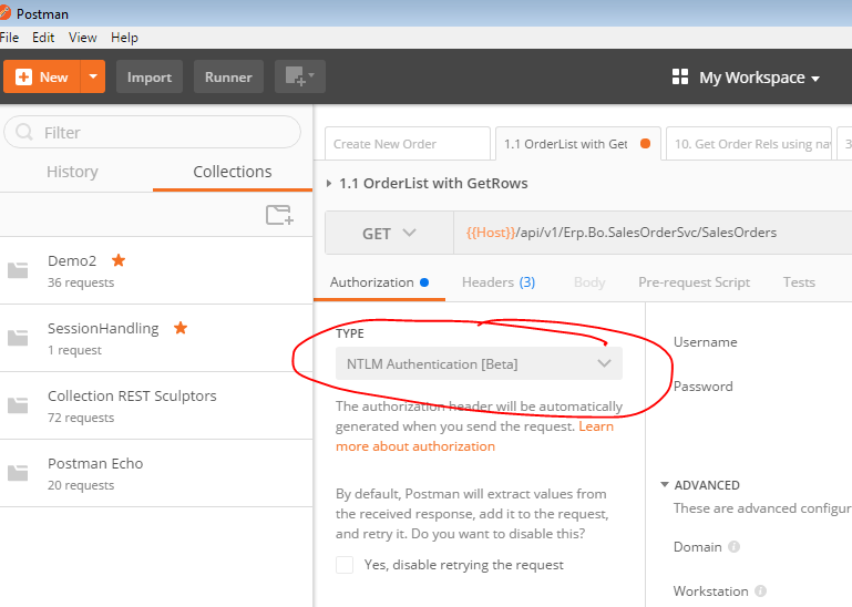

So once you disable Epicor password management, you need to flip in Postman from Basic Authentication to a Windows Auth approach instead. Think about how you can tell your browser to handle passwords.
Postman support of Windows Auth is in beta:

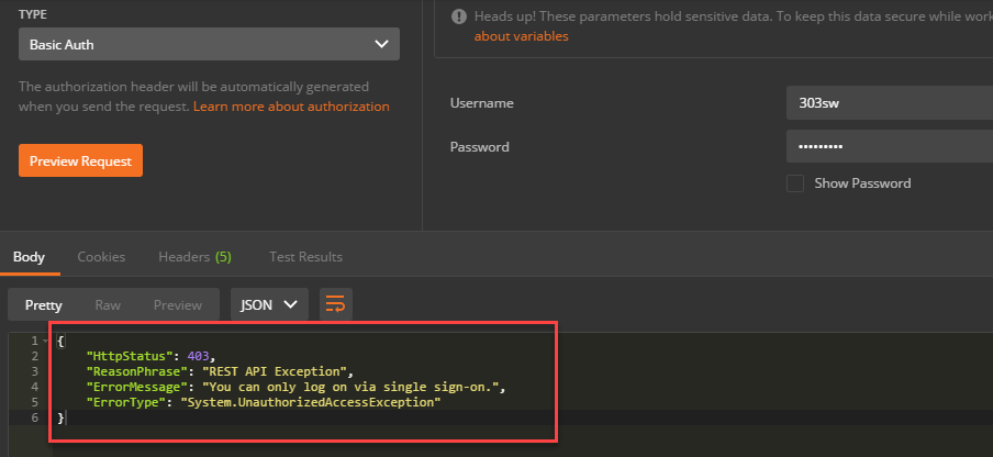

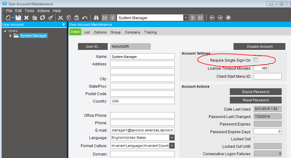

Require SSO means none of the Epicor username and password management is leveraged which is what I think you want.
Doing that gives me a new exception :slight_smile:
you successfully forbade yourself to logon other than using Windows credentials :slight_smile:
You can’t cross the streams :wink:
If you require SSO, / Windows Auth, you need to use Windows NTLM.
Basic Auth is for ‘custom authentication’ aka - Epicor Username/Password

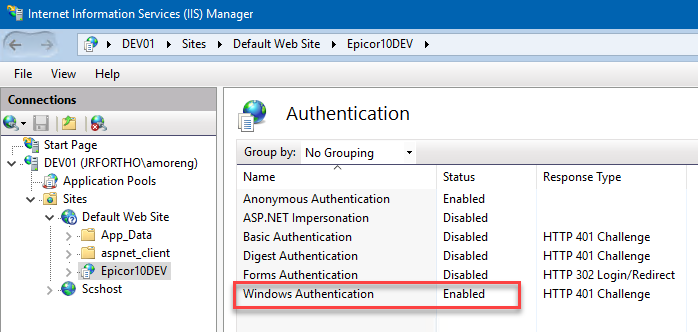

In Epicor, none of our users are marked as “Require Single Sign On”. We implement SSO via IIS (I believe).

you can get token in swagger Help page and use it in Postman. Or you can make Postman work thought NTLM, as Bart wrote that it is supported.

The ‘RequireSSO’ flag is to prevent a ‘Windows Auth Only’ user from having their account stolen when the account has a blank password. Now that there is autogenerate password and mail it to the user, I hope to never see another blank password user entry.
