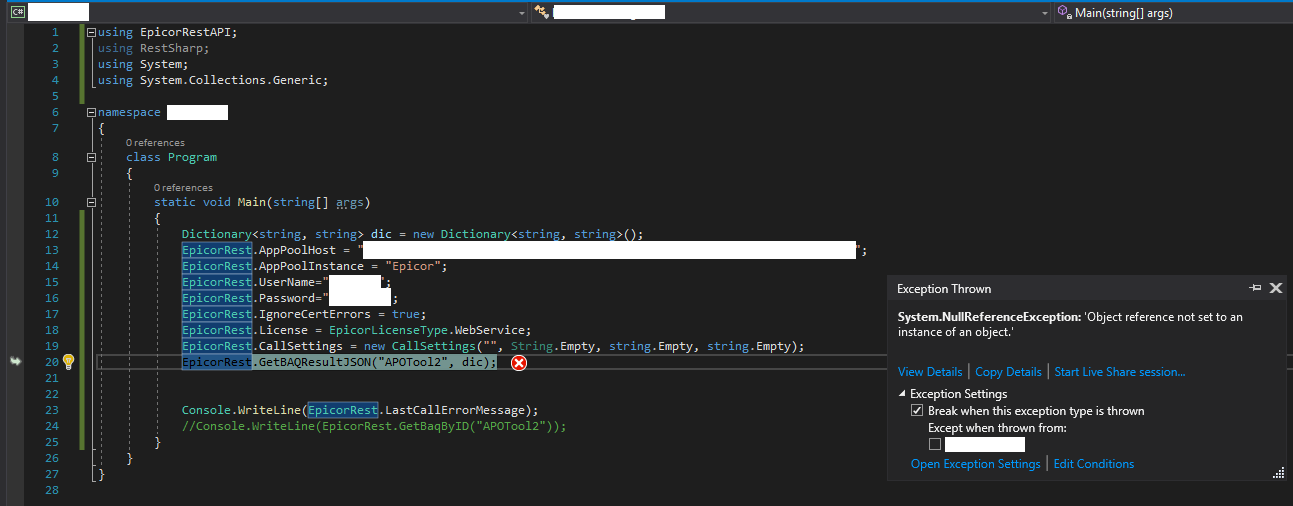

This is the code I have thus far:
I get the following error when I run the program:
Anyone know how to get around that error?
I think dic needs to have your BAQ parameters. Also make sure “APOTool2” is the correct BAQ ID, and is on the server you are targeting, and can be run by the user you are using for the REST call.

So in this case the BAQ is to be run wide open. What parameters would I need to add to get it to do? As for the BAQ id it is accurate and accessible for the individual.

var result = EpicorRest.DynamicGet("BaqSvc", "APOTool2", new Dictionary<string, string>());
result will be a dynamic object with the results of the BAQ.
@Evan_Purdy @josecgomez ,
I changed the line for the one you gave me I still get the same error.
I have to wonder if I’m putting in the AppPoolHost wrong. Could you tell me where to pull it from?
