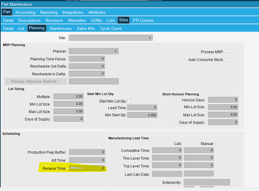

In Part Class maintenance, on the Site/Detail tab, you can set the Reschedule Time Out Delta and Reschedule Time In Delta to prevent MRP from making suggestions within that time frame.

In Part Class Maintenance, I also change the ‘Reschedule In Time Delta’ from 0 to 2. Again, no changes.
