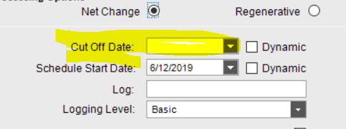

The post about establishing a proper cutoff date is accurate. Make sure that you are using a cutoff date that is beyond the demand date of the items you want to plan.
There is no “fence” per se, the cutoff date when you launch MRP determines how far out you want to plan to available demand. If your cutoff date is 12/31/2019, you won’t get any plans for demand that is 1/1/2020 or later. In effect, you set the fence each time you run MRP.

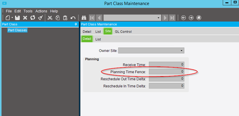

As others have mentioned, there is a cutoff date when you run MRP, but there is also a “Planning Time Fence” that you can set at the part/Site level AND/OR at the PartClass / SITE level (Part/Site “wins” over the partclass setting). If the partclass for the part and the part/site are both set to zero, then there is no timefence considered, so it will plan forever into the future (unless you specify a cut off date which will ALWAYS win).
Typically, I see most companies set teh planning time fence for all their parts and partclasses to zero, and they don’t use a cutoff date. BUT, that is different in some industries where they have shorter leadtimes, and/or just want to eliminate future details.

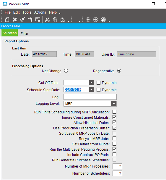

We do backdate the “Schedule start date” field approx 3 months to ensure we haven’t missed anything. here is how it’s set to run:
Update: I have been told that our MRP is working well now (we have the correct lead times for all procured parts). The issue we are having with jobs not being suggested is because they do not have the MPS turned on in Epicor.
Looks like I need to do more research on how we have the system currently configured.
Update: We are not using the MPS in Epicor which is why they are creating the jobs manually. MRP is working, PO suggestions are being generated.
