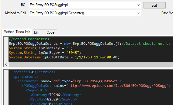

However I’m having a hard time understanding why my dataset list 0 rows in POSuggs.Generate. Preproc, Baseproc both have zero row counts for this.ds.POSugDtl and ttPOSugDtl. Based on my trace this method still has data.
But my for loop never fires with a basic message box. I have also displayed the row count. Not sure what I am missing

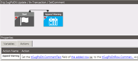

This just reminded of a hack I used for Sugg/POs to get a note/warning into my PO’s
Where I used a data directive on SubPoDtl.Update to write warnings to the ttSugPoDtl.Comment.
The comments are automatically copied over the the PO when generated.
Assuming you Buyers check the comments… might get you by until you answer your original question?

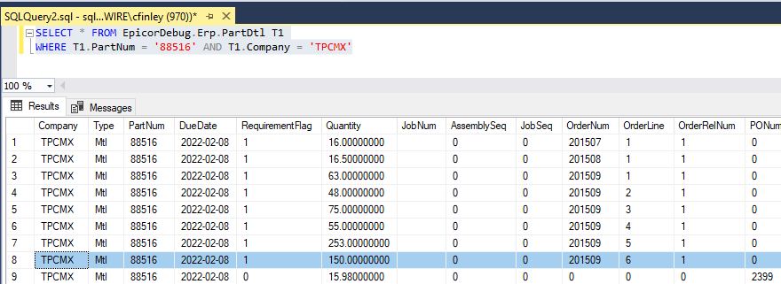

Is the delta visible in PartDtl records between the demand and the supply records? Is the quantity difference visible in buyers workbench? Or is it correct in both places but wrong when generated. I do a bunch of checking in GetRowsPlant to set warnings in a field and then row rules to color code the suggestions that need research before generation.
Thanks for @bordway and your input. To answer your question first @gpayne, we are seeing the discrepancy in New PO Suggestions right after we run PO suggs. So when the buyer opens open New PO Suggestions they see a suggestion with the incorrect qty. The qty seems to be correct in PartDtl
