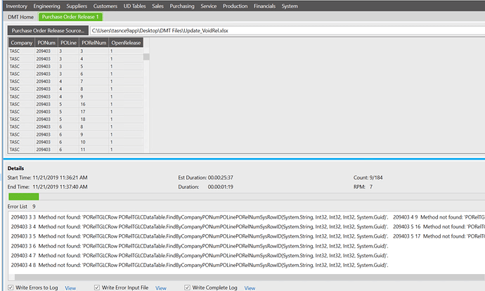

Can you remove a void from a PO Rel? I can reopen the line manually but can’t seem to update this in DMT. I do have a conversation going about my DMT error. I opened a ticket with Epicor but not much help so far.
I’m pretty sure I have successfully reopened the release using DMT in the past.
Have you tried doing ReOpenRelease = true ?
I noticed in your screen shot that your column name is OpenRelease. Can you try ReOpenRelease?
Try ‘TRUE’ instead of ‘1’?
@Kimberley - Did you try including the column PORelTGLC#TGLCTranNum
Look at the last post of your thread on the DMT error.
Yup…No luck still same error.
tried that and got an error too.

There are a number of other fields as well - Try Setting the “VoidRelease” checkbox to false. That would unvoid the release. Then look to see if the release returns to open status. If it’s no longer voided, but also not open, then I would simultaneously try setting the “OpenRelease” checkbox to True.
Also check to see if the PO Header, and PO Lines are open. There’s a hierarchy… when manually reopening a Purchase Order you end up having to Open the PO, then Open the PO Line, and then the PO Release (Same with Sales Orders)
With all of that said, I would still try setting the “VoidRelease” checkbox to false before doing anything else. That “ReOpenRelease,” I believe, has more to do with performing through the Actions Menu in Purchase Order Entry. DMT is a bit different - it’s changing the settings directly on the table, and typically doesn’t need to bother with fields that the UI utilizes in Action Menus.
