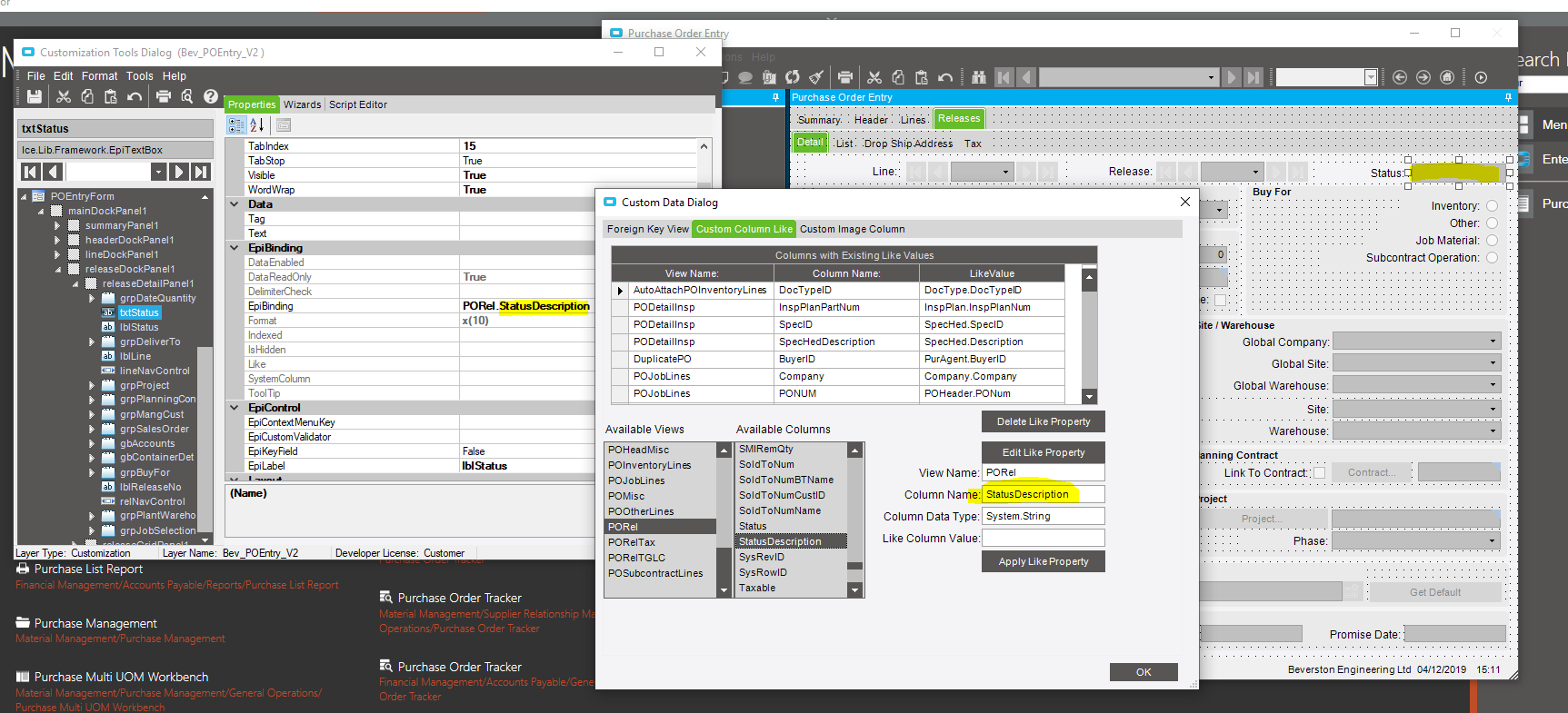

the PORel status is an -on the fly- form field, should be updated based on the VoidRelese Db field, and you are right, it seems that updating this field via DMT, i.e. (ExtUpdate) is missing to trigger the update for this form displayed field

if i were you i would get hold of the edvRow in the customization then set the displayed field value as per the VoidRelease value triggered by Row change event

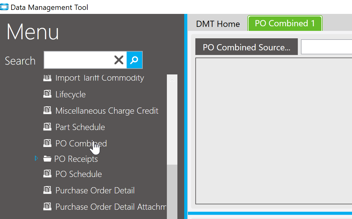

(and Al and Calvin :slight_smile: ) Thinking, oh boy poor Kimberley still struggling with this one! … I ran some testing with the DMT. Does your version have Combined option for PO ?
I have played around with various methods, po rels, po lines, etc, open true, void false which didn’t work. However, using the combined with the following fields worked! I think these “ReOpen…” fields from template are doing the job. Note, however, I had to manually reopen the PO, unapprove it, close it (all via PO entry) and do the upload with this data to get them all opened with status of open on releases as well.

I always for get about combined. Let me test it.

was your PORel closed before the DMT update, because using PO Combined did not work for me, it has the same problem, what Epicor/DMT version are you using?
Hi Al,
Yes it was a multi-line PO that I closed via actions dropdown. This closed the whole thing, all releases were closed, lines closed, header closed, and all marked as void. Then when playing around with the DMT to see if I could get it to update the status from void to open, I realized that I needed the closed PO to be unapproved. So, I went to Actions/reopen PO, unapproved it, and then Actions/Close PO. Then I ran the DMT per the attached csv further up and Bam! it worked :slight_smile:
Our DMT is 4.0.29.0 and Epicor 10.1.600.20
