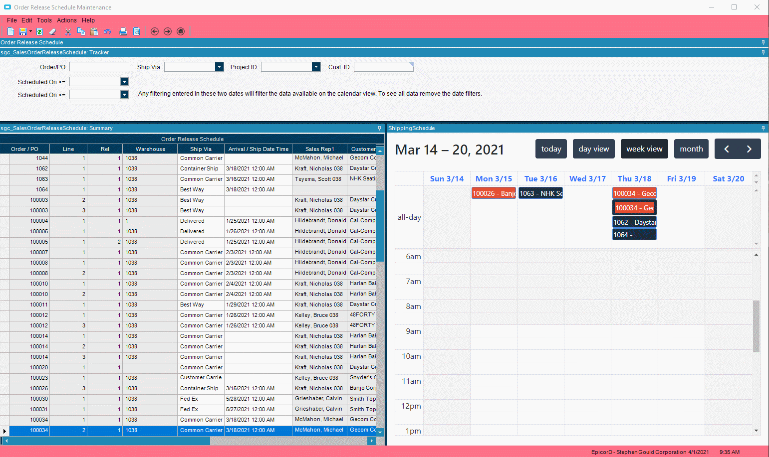

That is a sweet panel by the way Jose.
Thanks @utaylor its an implementation of fullcalendar.io hosted on an Essential Objects instance (same control used for kinetic homepage)

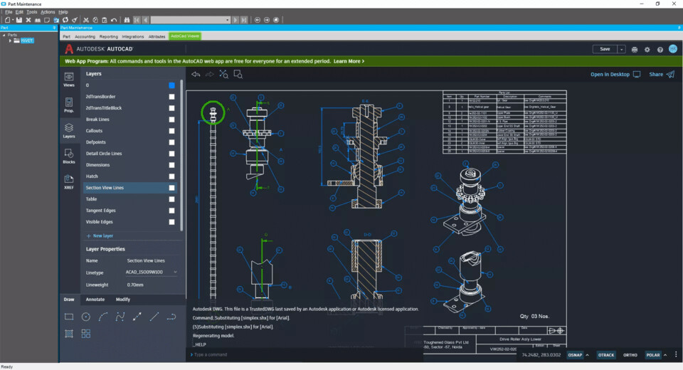

This is wild.
@jdewitt6029
That is really cool! And scary. I have enough issues with Autocad (and Epicor with Windows Updates recently) that combining them is a little … unsettling. :grimacing:
As for fullcalendar.io, i used that heavily in my suedo ERP creation back in the day for scheduling. Was awesome!
Hahaha yeah as soon as I saw autodesk I thought- that is awesome, but solidworks… can you imagine the support calls…? “Excuse me, you are doing what?”
I sent this post to our engineers and they all just died a little.
For SolidWorks they might want some hyperlink to open up the PDM Vault Viewer (web app) :slight_smile:
