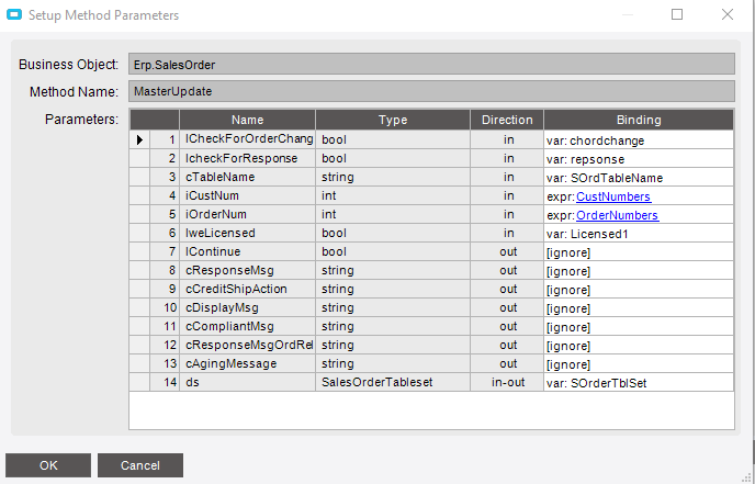

Decided to create a Pre-Processing BPM on CustShip that just simply said ReadyToInvoice from False to True, then set as an Post directive.
Next, created an Post-Processing BPM that calls that directive and then invokes the BO SalesOrder with MasterUpdate for Method.
Now, I am working out the parameters linkage. I am currently tracing, but didn’t know if anyone had any input on these.
I have this setup, mostly now. Only one hiccup. So far, here is what I have.
BPM on CustShip.UpdateMaster
Pre-Processing: If ReadyToInvoice goes from false to True, then set as Post Processing directive.
Post Processing: Is activated from Pre, invoke Function OrderHeader with parameters of OrderNum=ShipHead.OTSOrderNum as OrderNumbers and Custnum=Shiphead.Custnum as CustNumbers.
OrderHeader Function: invoke BO with Paramets of OrderNum=Ordernumbers and Custnum=Custnumbers.
I then have it set to show a message with some info inserted from the OrderHed table. Nothing from OrdreHed pulls through. So, I am guessing that I am missing something here. Any ideas I can look for?

nope, you’ll get to do a get by ID to populate that data set. You need to follow the trace from making the change in the UI. All the calls that that BO makes. So turn on tracing, then open the screen, have your values ready to you can type them in instead of search for a cleaner trace, then follow that trace to a T.
Thank you! I go the GEtById, and then I noticed it wasn’t updating in the table, only in the dataset. So, took another look, with some help, and found out I needed to change RowMod to “U.” Thank you!

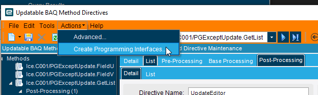

A thought that came to mind I wanted to ask you about. If I was to build a UBAQ and use the Advanced BPM option, do I need to sue the GEtByID or is that inherent since I am running the BAQ?
My thought is, for me, I only need to update the filed, so I could just put a post processing BPM on the update. My limited thinking is that the BPM would fire when I clicked update.
Is this correct, or do I need the GetByID in this scenario as well?
EDIT: I misunderstood your question.
If you are using the standard update for the update part, and you are just adding something to that, yes, it’s doing all that for you.

If you set up the standard BPM update then look at the create programming interfaces, you can sometimes see what the standard update is doing. They will have their own getbyID (or some type of getby) in there, which is why it has required fields, so it can actually run that to populate it’s dataset.
NICE! Saw that but hadn’t played with it yet! Thank you for the info!
