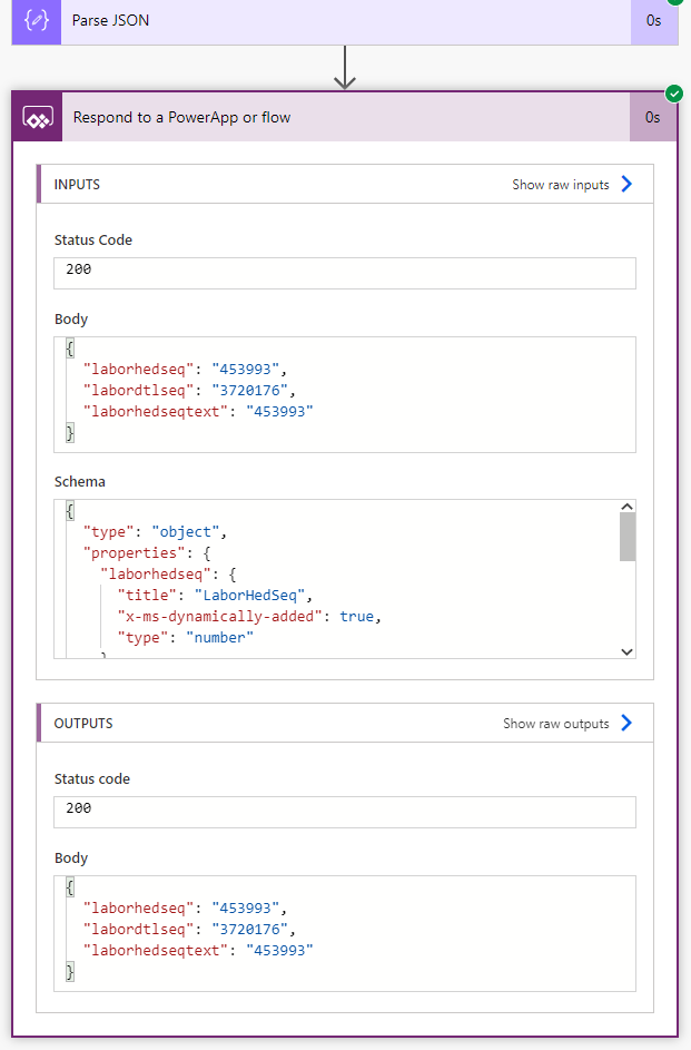

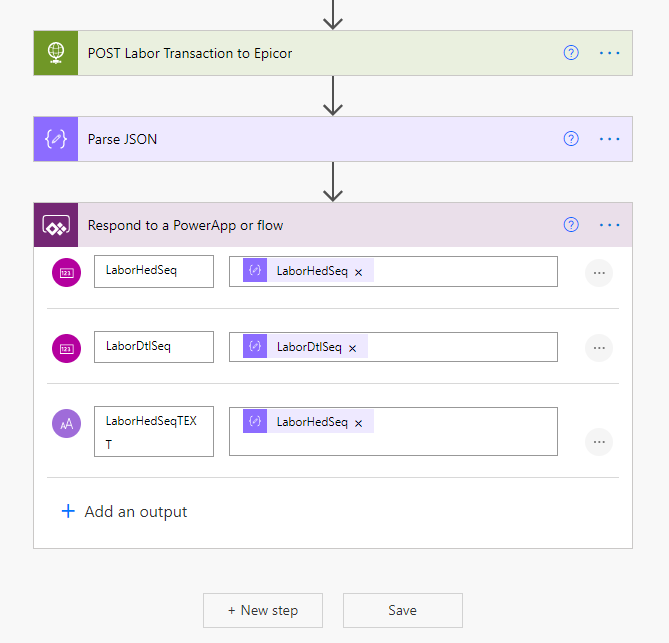

Oh KAY, that was ridiculous! Got it figured out finally.
#1 - The action I need is… Respond to PowerApps! It’s its own thing.
Expand for pic
#2 - It’s buggy!

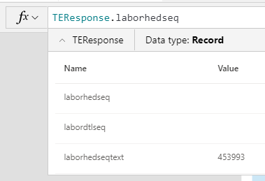

I get responses...
But not in the App
Turns out that “numbers” don’t actually work. Well… UNLESS you make the first and last response as strings and then couch the number between them. (See this thread and jump to the last post for the solution.) Or just send the number as text instead and be done with it.

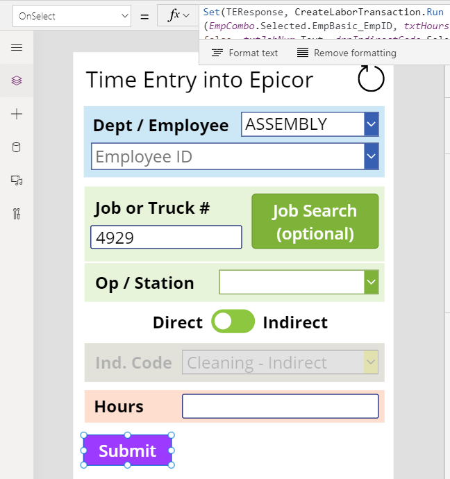

#3 - A tip: when changing Flows that are already connected to your Power Apps, always delete the connection and re-add it - and make sure to copy (to Notepad) the text of all formulas that use the connection.

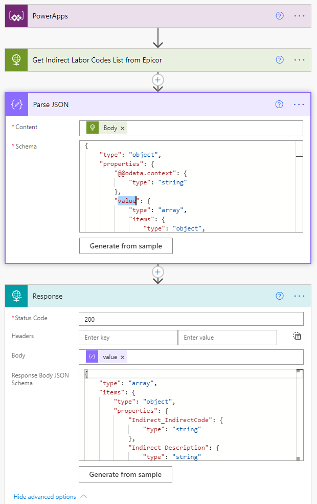

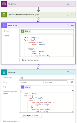

Just to expand on this, the flow looks like this:
Click to see pic
From Swagger, I get the response JSON (I use top 1 results for simplicity)
  "@odata.context": "https://URL-Stuff",
  "value": [
      "Indirect_IndirectCode": "ICLN",
      "Indirect_Description": "Cleaning - Indirect",
      "Indirect_ExpenseCode": "ICLN",
      "RowIdent": "bf86e375-b752-4496-b735-d999d5f3b9ef"
Here’s the tricky part. When you do “Generate from Sample” on the Response block, you want to copy and paste ONLY from [ to ] (from square bracket to square bracket). So I pasted this:
That’s different than what you use for the Parse JSON step!
Then you call the flow from the Power App like so:

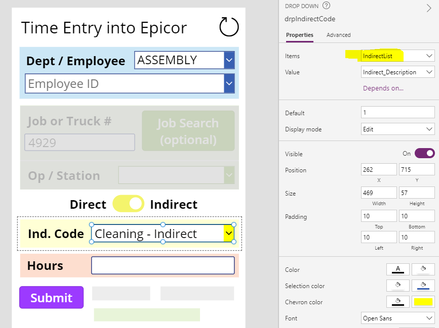

ClearCollect(IndirectList, IndirectCodes.Run())
  • ClearCollect() makes a “collection”
  • IndirectCodes.Run() calls the flow
  • IndirectList is the name of the collection that I will use throughout the app
Like this drop-down:
