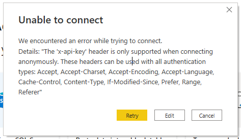

I wanted to put the API key as a header, but it looks like you can’t with basic auth.

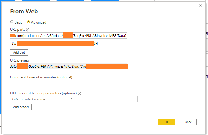

So I saw a hack where you put the API key in the URL (I used the “parts” just for fun). And this seems to work.

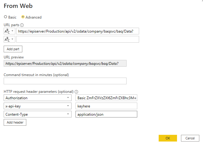

You can get V2 to work if you pass the x-api-key and encoded authorization through the headers:
EDIT: Then you could use an on-premise data gateway to have Power BI Online auto-refresh published reports that use the endpoint.
Right, I mentioned that in the original post, but I got the error that I showed.

It’s still basic auth, just manually passed through the http headers instead of having power bi add it for you.
power bi would do the encoding for you, but you can also do it manually. The encoding is just user:password in base64 ( https://www.base64decode.org/ can do it )

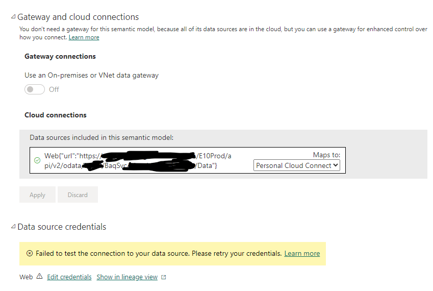

I can get the report to pull in the data, but it doesn’t seem to allow connection to an on-premise gateway and the credentials fail as configured in the http headers.

Yes we have this working with the workarounds mentioned above. May be an issue with your gateway installation/configuration. It looks like you have that data source in your screen shot configured as a cloud connection, not a gateway connection. If you go into that “Maps to:” drop down menu, you may have the option to “Add to Gateway”.
Found this post while searching endlessly for solutions to what I believe you’ve managed to resolve, but I still can’t figure out what I’m doing wrong. I’ve got my connection setup with x-api-key and basic auth in the headers, works perfect in desktop app. Pushed my PowerBI report to the web, tried to refresh the data but getting the credentials are incorrect message. They’re not incorrect. What I’m I missing?
