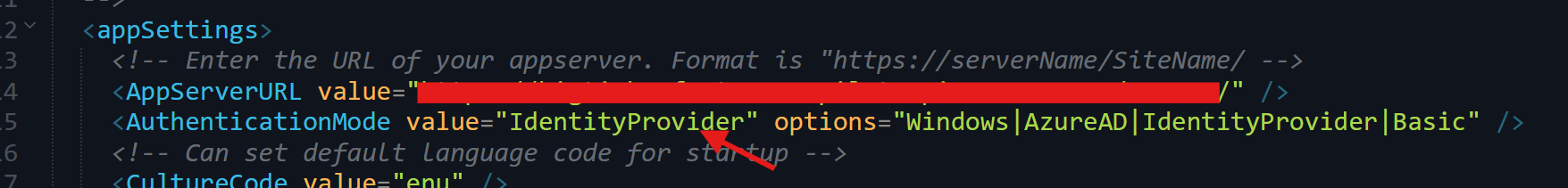

I had to open the sysconfig file and change the AuthenticationMode property to “IdentityProvider”
Here are the correct steps DMT server and client mistmatch - #6 by Hally
Hi Kevin, I did changed the default.sysconfig file but it still open in Basic AuthenticationMode
Are you sure that is the configuration file your power tools shortcut is referencing?
Hi Alisa, I right click on my power tools shortcut and select Open file location then go to config folder to change the default.sysconfig, is it the correct steps?
Problem solved, I have to change in [KineticServer].sysconfig instead of default.sysconfig, thank you so much.
