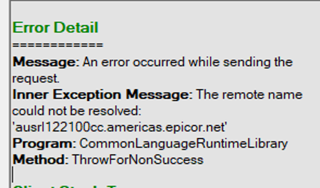

Any idea how to get Power Tools to work post the upgrade? Uninstall and reinstall did not work. Getting this error.
I’m not cloud so I’m not sure if that hostname is correct. May need to open an Epicor ticket.
I actually have it resolved - I thought the power tool was pointing to one config file but it isn’t pointing to a different one. Updated that and it works. Note: for anyone downloading the powertools from the web browser, previously there was only 1 config file, now it is downloads 10 or more.
I just downloaded the new version for a client, it came with 11 different config files.
TYPICALLY the correct config file is “server.sysconfig”.
When you run the installer, the correct Appserver setting (for DT and Gov Cloud at least) is:
[servername].epicorsaas.com/server
This is subject to change without notice, but it worked for both 2026.100.5 and .7
Yes, that is what I thought too. For us it was default.sysconfig this time.
