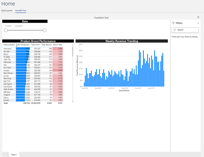

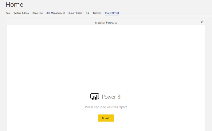

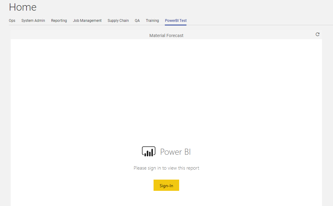

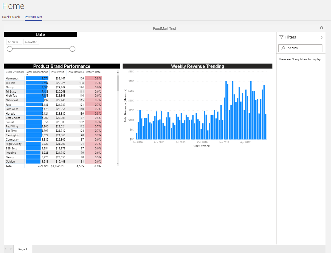

Kara,
Glad we’re having this conversation - it reminded me to test web access. Guess what - no issues there. So I can’t use it in the smart client, but it is seamless when accessing through a browser. I’ll open a ticket and see if it gets anywhere.
In case you haven’t tried go to:
your server url /Apps/ERP/Home/#/home
I’m SaaS just so you know.
Here’s a test logged in through a browser:
Corresponding test in Client:
I think this browser thing is going to catch on…
