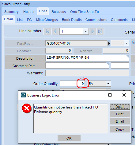

When a line on a sales order is marked buy to order and is linked to a PO, you cannot change the part number. You cannot reduce the SO line quantity to less than the Linked PO Release Quantity:

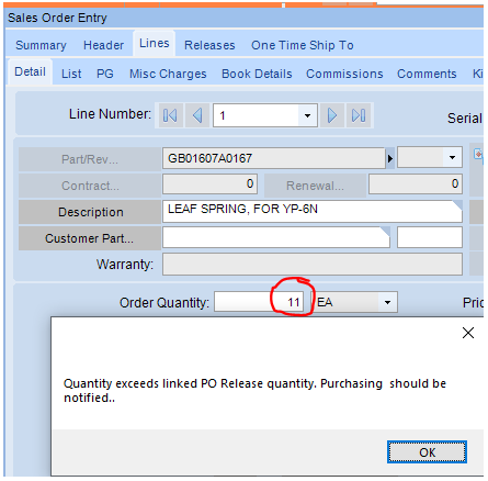

If you want to increase the SO line quantity you get a message to notify Purchasing.
If the user fails to notify purchasing, a new PO suggestion will be created anyway for the additional quantity needed.

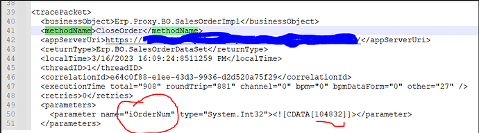

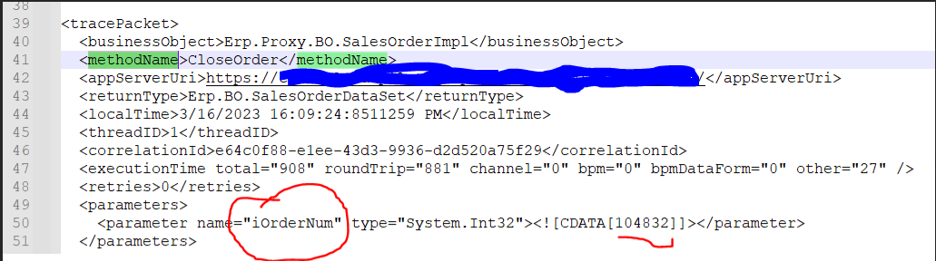

I have run a trace and have seen the Methods as CloseOrder, CloseOrderLine, or CloseRelease.

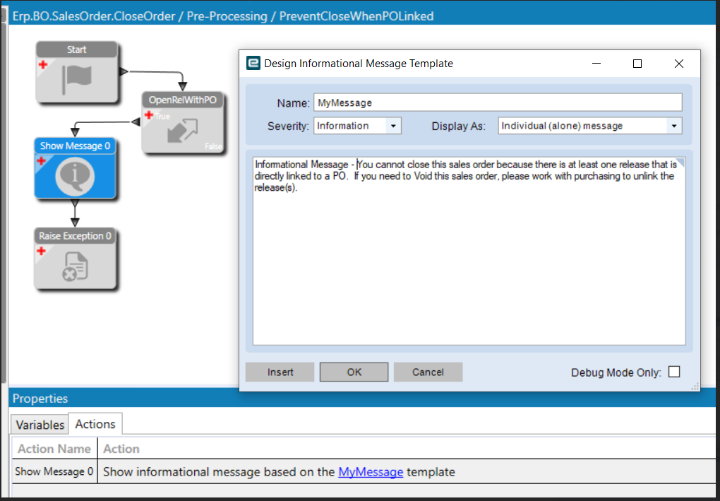

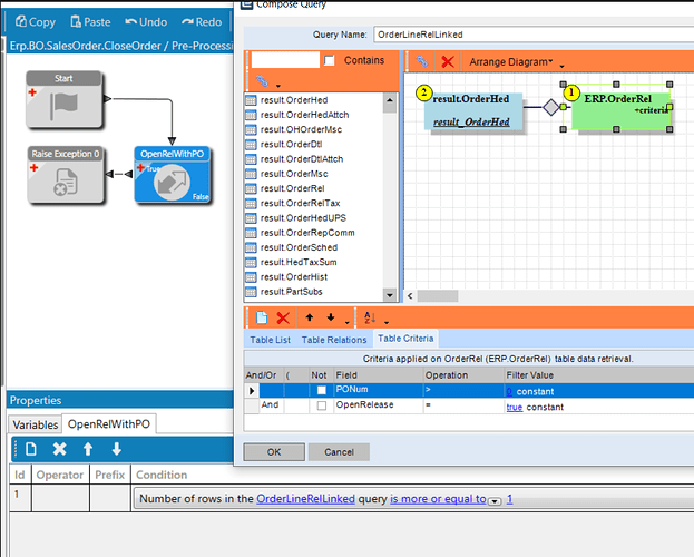

What is the best way to prevent a user from closing an Order, Line, or Release that has at least 1 open release that is linked to a PO? I have tried a pre-processing MethodDirective (starting with CloseOrder) and I was still able to close the order.

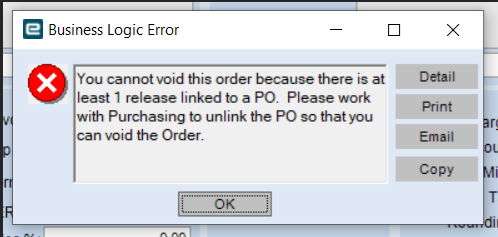

On my Erp.BO.SalesOrder.CloseOrder - preprocessing method directive, I put in the condition: “Number of rows in the Query is more or equal to 1”.

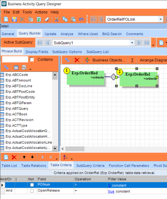

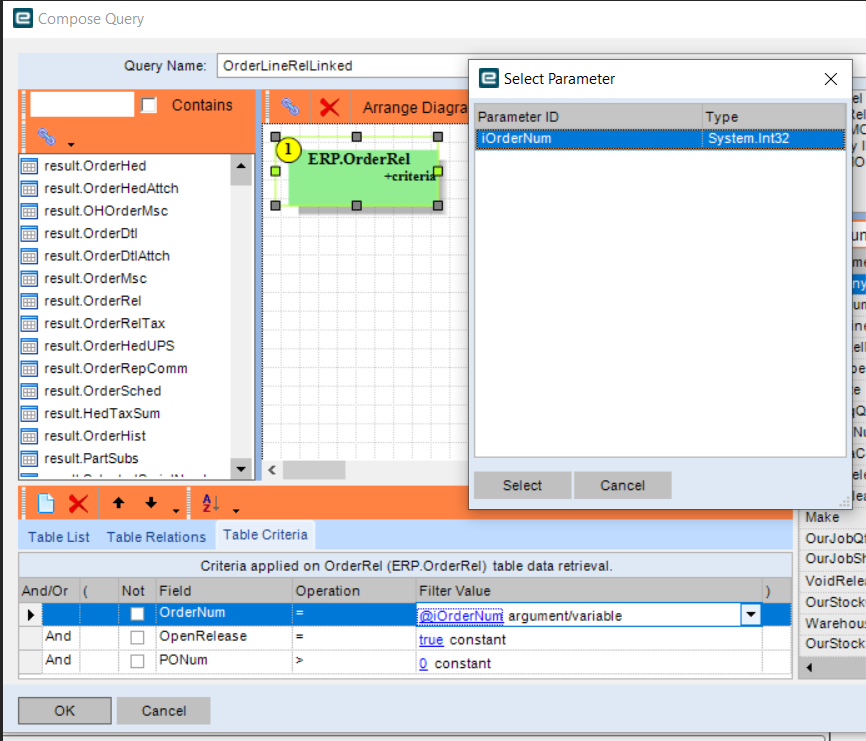

The query links the result.OrderHed table to the ERP.OrderRel with the criteria on the OrderRel as OpenRelease = true and PONum > 0.

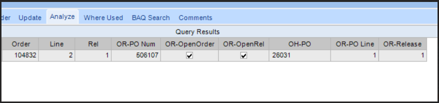

I have a BAQ with the Erp.OrderHed table linked to the Erp.OrderRel, using the same criteria on the Release (the criteria on the OrderHed is = to the order number I am testing.

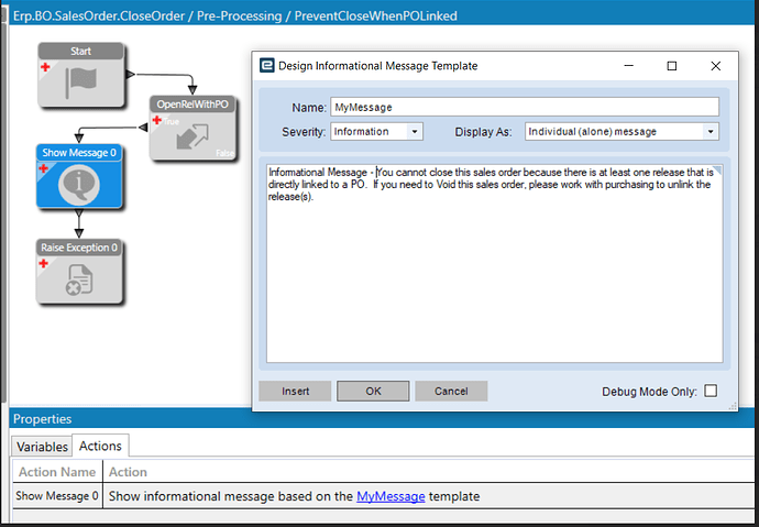

A strange thing is occuring. I have a leftover informational message, but for some reason, Epicor seems to skip this message and jump right to my Exception message:
