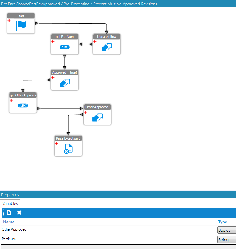

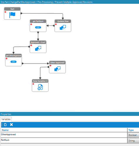

I ended up creating a method directive on the Part.ChangePartRevApproved method. I looked at the ipApproved parameter passed to the method and if it was true, I set my OtherApproved variable to:
(from pr in Db.PartRev
where pr.Company == callContextClient.CurrentCompany
&& pr.PartNum == PartNum
&& pr.Approved == true
select pr).Any()
Then I passed that variable to a condition widget and if it was true, I raised an exception with a message. I then had to make a similar BPM on the EngWorkBench.CheckECORevApproved method for when a user tries to approve/check-in from there. I would’ve rather used a Data Directive since it would’ve covered all my bases but it was doing wacky things when I tried that… so I resorted to the method directives.
