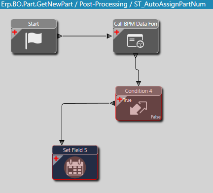

Thanks to lots of posts here on how to auto-generate numbers I have a working BPM (Post-Processing on Part.GetNewPart) to populate the Part Number field with a prefix/sequence based on a user selection in a BPM Data Form when “New Part” is clicked**.

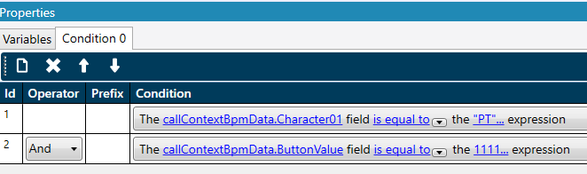

My question is: Do I need to have all these Condition/Set Field widgets or can I consolidate to one of each with some correctly written C# in Set Field? (Details below)
PartType
(Changing our part numbering logic is a whole different issue -I’m working on that but right now just trying to eliminate an Access DB that is used solely for creating new part numbers… don’t ask)
It works fine but was wondering if there was a way to reduce all my Condition/Set Field widgets to just one Condition (‘user clicks OK on the form’) and then test for the possibilities in one Set Field expression.

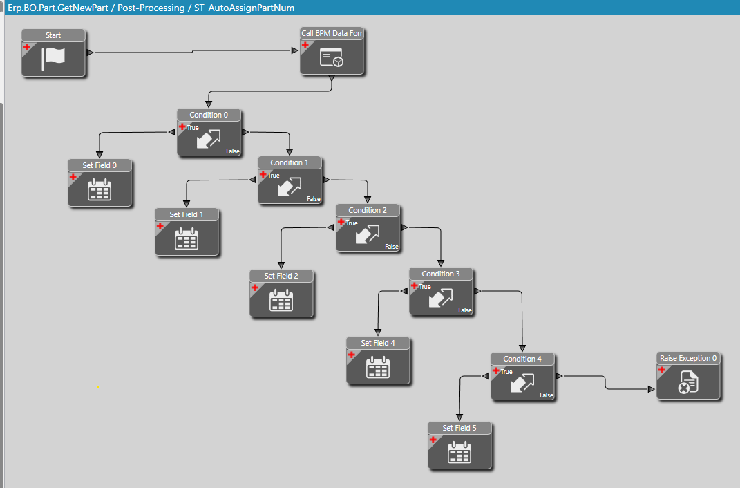

What I have now:
Where I specify the sequence to use in each of the Set Field widgets uniquely per choice made in the form using “new Ice.Lib.NextValue(Db).GetNextSequence(“ST_PT_NumSeq”).ToString(“PT00000”)” changing the Sequence name accordingly.
What I think I ‘should’ have:

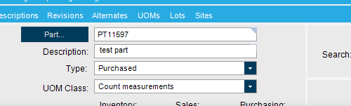

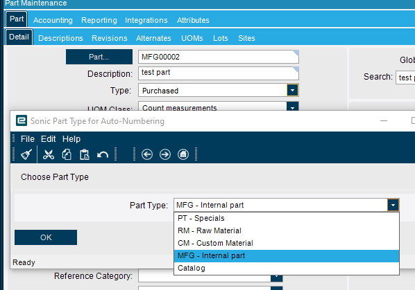

**Note - this only works in the classic form… in the Kinetic interface it presents the choice over and over again and never gets to the New Part form. If there is an easy fix to this please let me know!

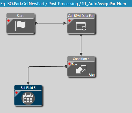

Awesome @dr_dan - thank you! My BPM now looks like this:
with this as the expression in Set Field:

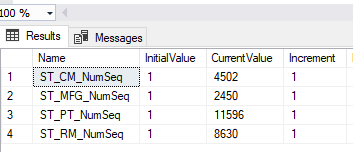

As far as looking up the next number, each of those sequences (“ST_PT_NumSeq”, “ST_RM_NumSeq”, etc.) get created in the Ice.SysSequence table the first time they are called via GetNextSequence.
This is in my test DB:
Is that what you were looking for with your question?

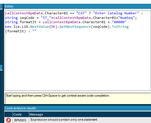

Thanks @timshuwy! I think I still need one ‘if’ statement because if the user selection is “CAT” we are using custom, non-sequenced numbering. I was thinking I should test for that first, then use your code as the ‘else’, so I tried the following but am back to the “Expression should only contain one statement” message.
callContextBpmData.Character01 == "CAT" ? "Enter Catalog Number" :
string seqCode = "ST_"+callContextBpmData.Character01+"NumSeq";
string formatIt = callContextBpmData.Character01 + "00000"
new Ice.Lib.NextValue(Db).GetNextSequence(seqCode).ToString(formatIt) : ""
Is there an easy fix to that?
Putting the IF statement “first” would be the way I would do that.
Complete ignorance here, but I thought that’s what I was doing by putting the ‘CAT’ ? statement at the beginning. I thought I could then use your code as the ‘else’ (after the colon) for the other cases. That’s where I am running into the ‘Expression should contain only one statement’ message. I am guessing it is some very simple syntax error on my part, but not sure what needs to change.
Ahh… you cannot have multiple statements in one of those in-line if statements. You will need to use a regular if statement:

I am clearly missing some fundamental understanding of how this should work. Based on your last note I tried this but am still getting the same “Expression should contain only one statement” error:
if (callContextBpmData.Character01 == "CAT")

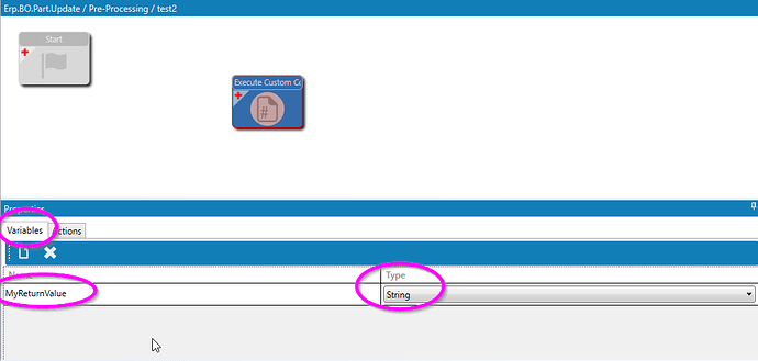

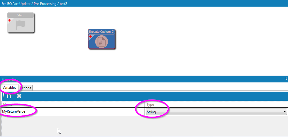

but FIRST you should create a VARIABLE in the BPM that can be used to pass data. Then you can use that variable in your c# code widget.
In my example below, I previously created the variable MyReturnValue and then used it

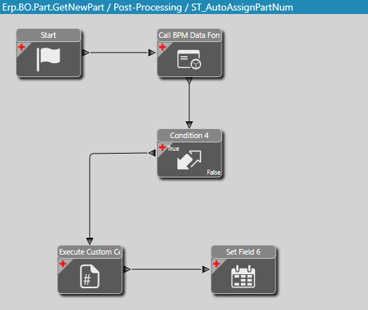

Thank you everyone! I am now creating the variable, using @timshuwy’s code, then setting the PartNum field in the Setter.

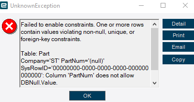

Note: I had to set the Custom Code widget to execute ‘Synchronously’ as Asynchronously would throw a ‘Failed to enable constraints’ error (screenshot below**)
Also, just to clarify for anyone else, all three iterations of the BPM I posted do work fine, but to Tim’s point I could now just add a new value to my form and not have to go in and update the Directive code and/or widgets.
So I definitely achieved my goals of learning something and improving my existing BPM. Here is final layout:
**Async error:
