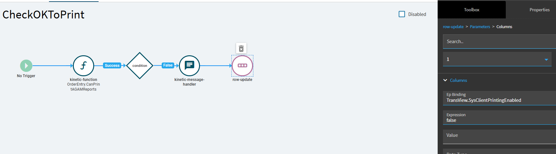

I have added a layer to the ICE.UIRPT application for the BAQ Report which copies “%session.context.initialValueIn.ValueIn%” into ReportParam.Option01 which in this case is a Sales Order Number.

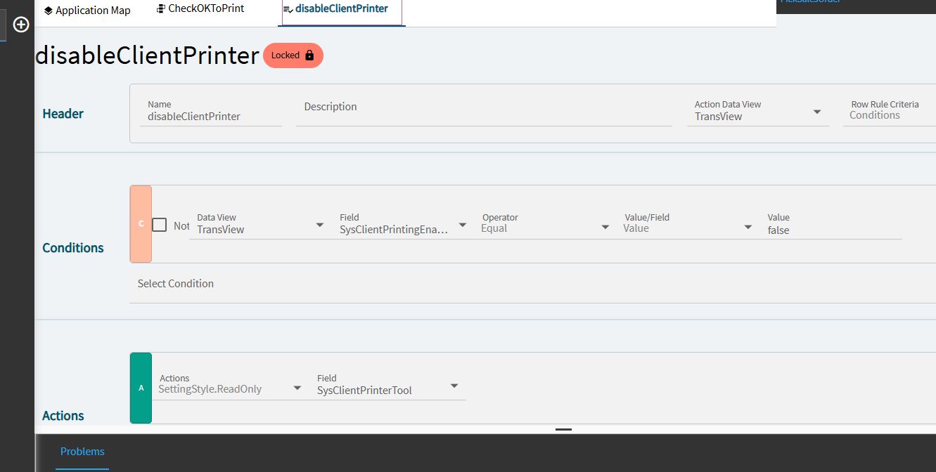

There is an addtional requirement that the report be supressed if the Ship To Address has not been validated by Avalara. So I have created an EPicor function that takes the OrderNum and checks if all the conditions have been met. If not it returns an error message which I display to the user. I would like to simply close the entire application but the app-close doesn’t do anything, so I thought I could disable the action items Print Preview, Client Print and Server Print but I can’t seem to get those page tool items disabled, either using property-set on the controls or row-update on the TransView fields which the Row Rules use to Disable those action items. So the user is still able to preview and/or print the report.

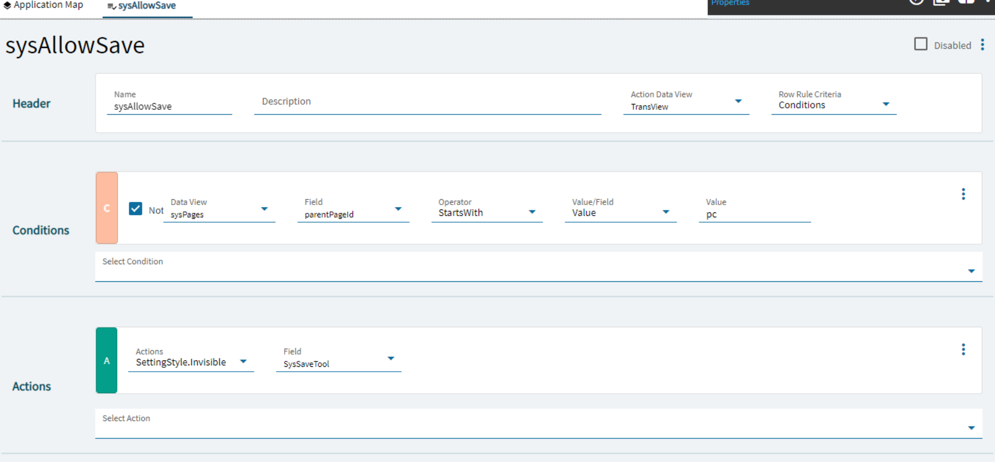

Trying using the visibility property instead. This way you can just hide the button from view.
Something like this should work for what you need:
When do the row-rules get re-evaluated? Or can i force a re-evaluation from an event? So far I can’t get the row rules to re-run when I change an associated TransView field.

I tried using property-set to set the buttons invisible based on the id’s of the Tools item, but that didn’t work properly.

Does TransView have a field ‘SysClientPrinterTool’ and is that the epbinding value on your print button?
