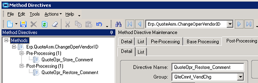

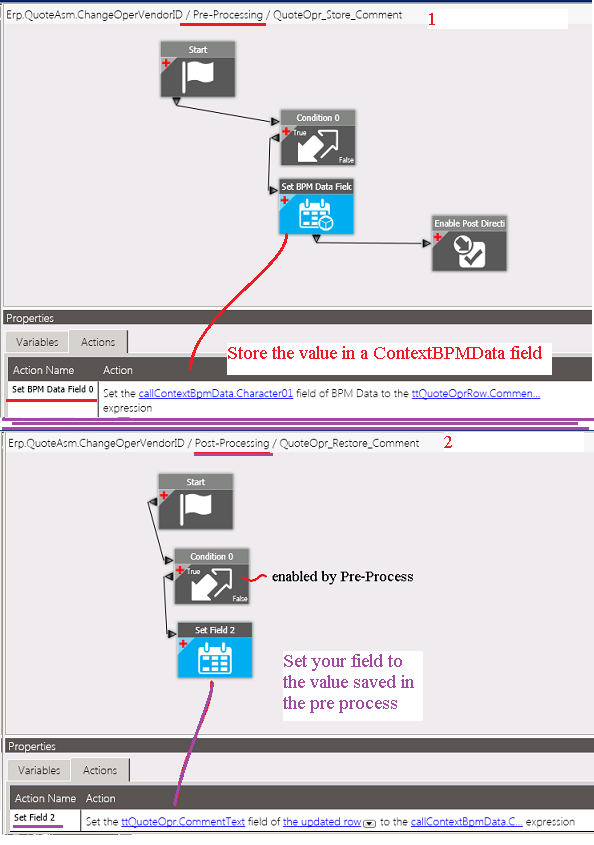

Optionally you still might be able to get a BPM to preserve your value too.
Here are a couple screen shots of a simple example I used to preserve operation comments when the Vendor is changed on a subcontract op.
I tried that BPM and couldn’t get any results. Quote Entry REALLY doesn’t want to cooperate with me.
