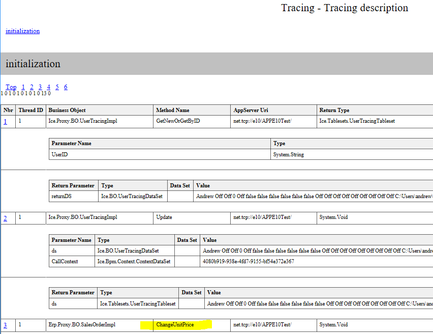

In a trace, I can see the Erp.Proxy.BO.SalesOrderImpl.ChangeUnitPrice method being called, but I can’t seem to access it via either the Before or After adapter method test.

BUT… the trace does show a method being executed…

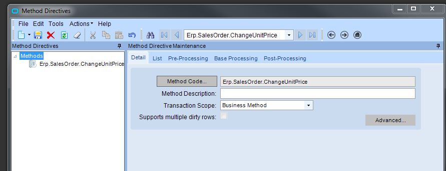

Have you thought of using the BO mentioned in the trace?
Thanks Ken. This is in a customization, not a BPM.
If I were trying to accomplish 1 single thing, I’d use a BPM, but the overall customization has quite a bit of interactivity to it - so I’m using a UI customization.
