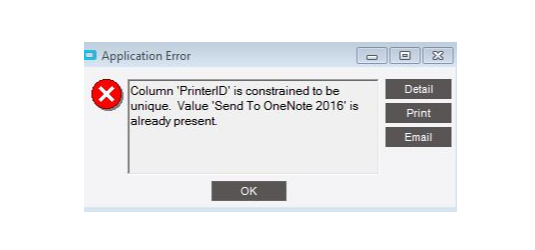

I have a user that is getting this error when they try to print. They can print preview fine and print that way. Anyone know how to fix this? I am guessing he clicked something. He has done a few odd things in the last few days.

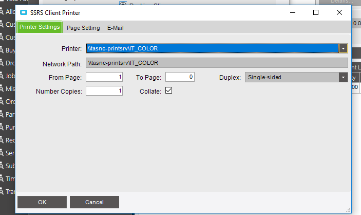

Even if they did. I would think this is the screen most users get to select a printer. this screen…

He never gets the screen SSRS CLent Printer…Just the error. That second screen shot it what he should get.

I logged on his computer and I get the same error message. I have changed his default printer and set it back. I have cleared client cache…no luck
Ah-ha! I understand now. Sorry, I was confused as to where the screenshots were coming from exactly. Okay, I believe I’ve run into this sort of thing before, I think…but it was much easier to set the ā€œEpicor Default Client Printerā€ in E9.

I get the same error when I log on Epicor on his computer so not a personalization. Plus it is happening to anything he is printing.
