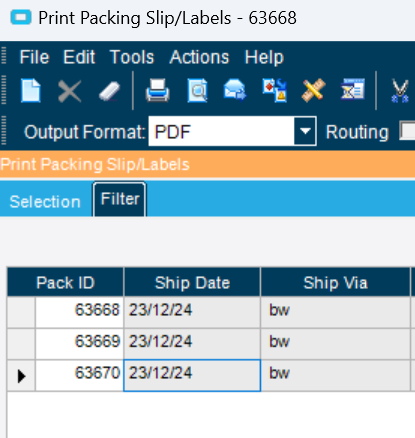

Previously in 10.2.300 we used to be able to add multiple packing slip numbers to the filter in print dialog, but in 2024.2 there doesn’t seem to be an option to add or search for more in the filter section.

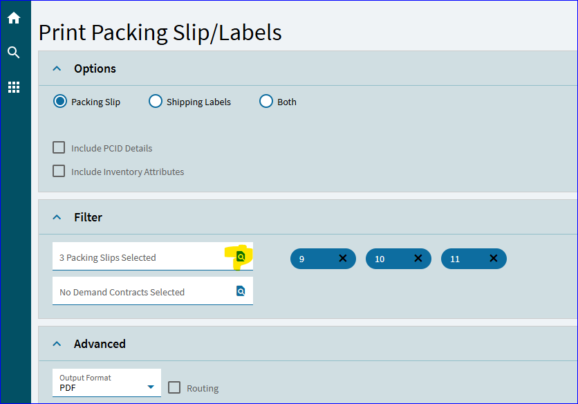

When you use the search in the pack slip filter you should be able to pick many. Even if you type in one, then you should be able to go back and type another one and it will add another little blue search chip.
@Hally, is that a custom menu?
From Customer Shipment Entry, if you print a packing slip, the search is greyed out… so you can’t edit/modify the search and select multiple slips:

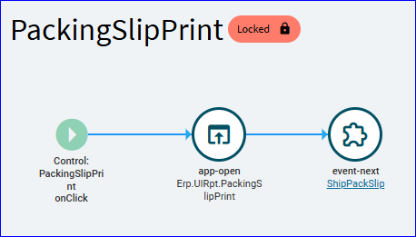

I thought this was perhaps because, watching the event, it is showing that this is being opened via CustShipTracker (even though I’m actually using Customer Shipment Entry)?
I customized (overrode) the event to open with CustShipEntry… but same result. Still greyed out.

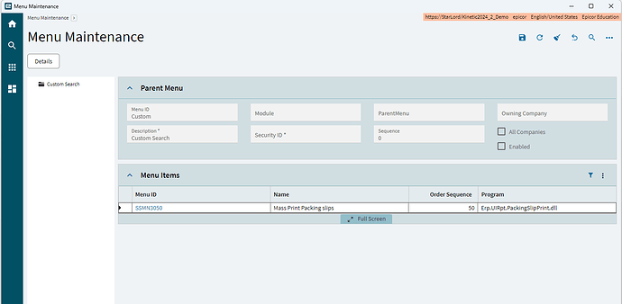

@aseidel The easiest way around this is to create a new menu to enable a Mass Print.
  • Search for the Erp.UIRpt.PackingSlipPrint “process” in menu maintenance…
  • Copy it to current company
  • Give it a new MenuID if you want.
  • Change Module to “UD”
  • Give it a Parent Menu ID of the menu where you want to find it. Because this is a “Process”, if you just copy the menu, you still won’t see it unless you change the parent to a menu folder.
  • Example, I set mine to SRMN1000… this is “Material Management > Shipping / Receiving > General Operations”
I can now see it in my menus…
… and via that menu, I can now select multiple slips to print.

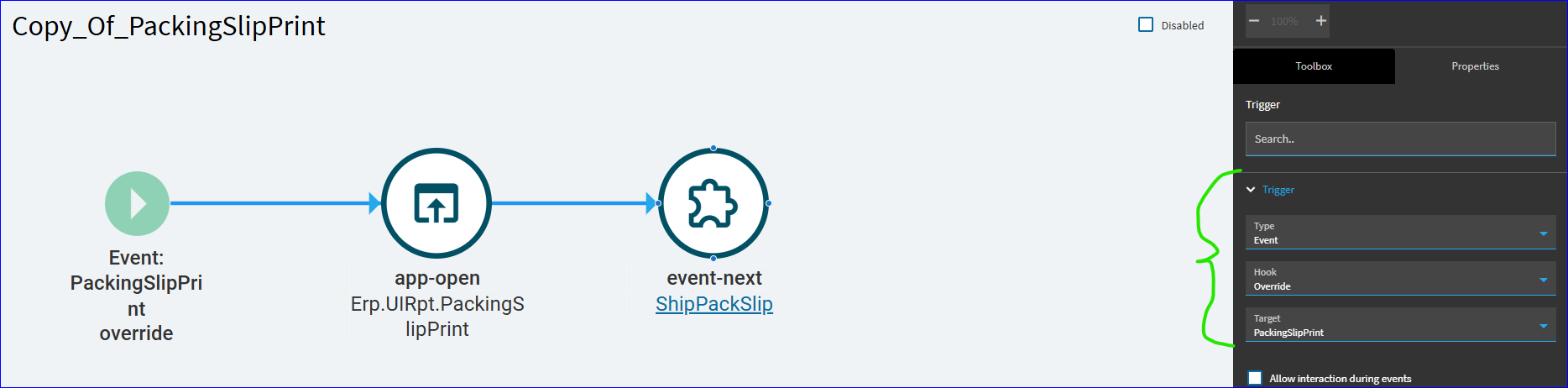

But… check this out… circled in Green above is the actual reason you can’t modify the search in Customer Shipment Entry. So… that may be another work around if you DON’T want your users to have to go to an independent menu!

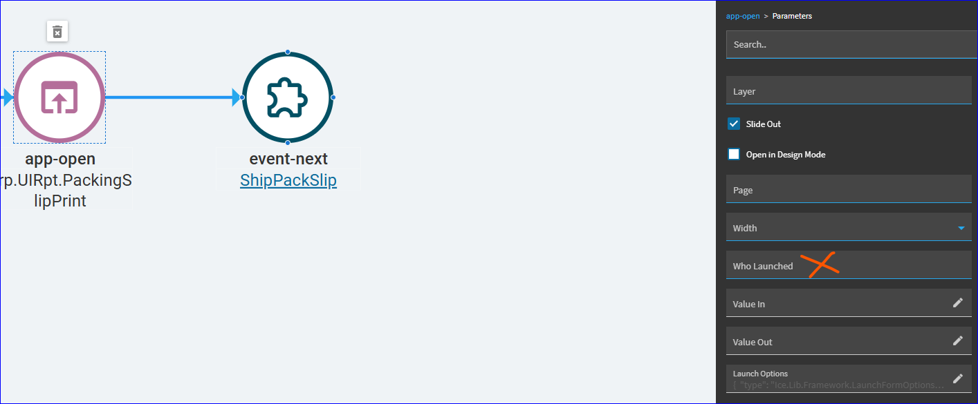

If you want to tackle it this way, you’ll need to customize Customer Shipment Entry.
Create a Custom Layer (if you don’t already have one). We need to modify the below event (but can’t… so you’ll need to copy it and override it).

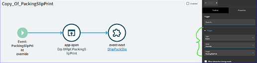

In the event search, right click on it and choose “Copy”
In the new (copied) event… rename it if you want… then modify the trigger like below so it will override the existing event:
Then in the App-Open widget, delete the “Who Launched”. Make that blank.
Now from within Customer Shipment Entry… I can modify that search and choose multiple pack slips if I want:
