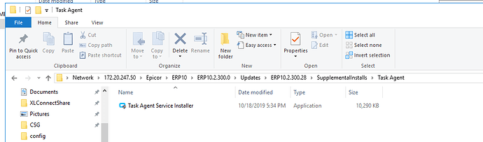

  • and also deploying it from the supplemental install folder for 10.2.300.28\172.20.247.50\Epicor\ERP10\ERP10.2.300.0\Updates\ERP10.2.300.28\SupplementalInstalls

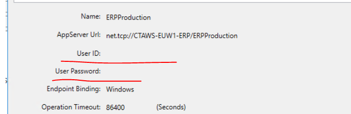

Can you login as the user ‘print’ using your Epicor Client and the Password you believe to be correct.

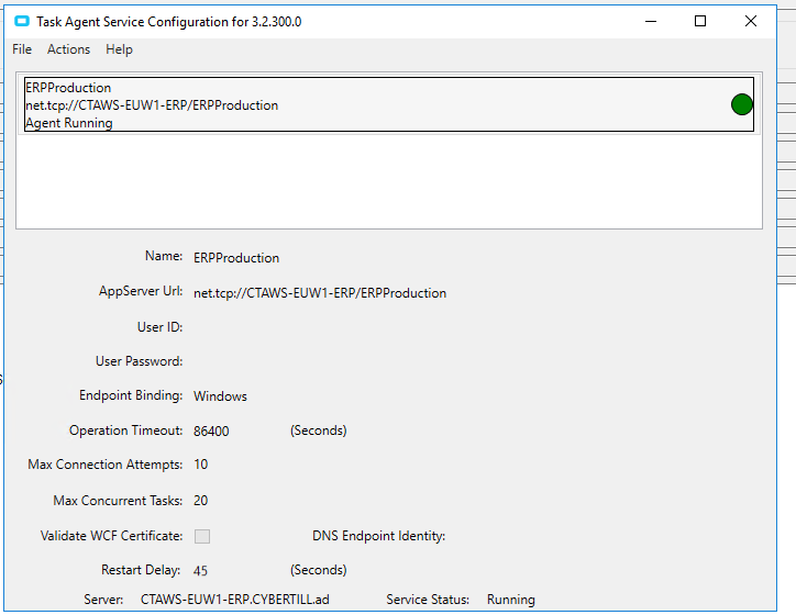

Also do you have any errors when on the Screenshot Window above you go to Actions -> Event Log (something like that).
Because I see it says User ID: blank
Make sure you set the print user and password. I know Print Agent for us didnt work with SSO so we had to make sure we use a user/pw (or was it the other way around).
Perhaps your Endpoint Binding also needs to be UserNameWindowsChannel
Thankyou for such a quick reply, and on a Saturday! Just checked our test setup and it’s normal for user id and password to be blank.
I’ve never tried or had t login as ‘print’ or any other user, we use SSO via windows.
I’ve looked at the event viewer and it doesn’t seem to record anything when an attempt to print get stuck in scheduled tasks, but I have found some information which will help me debug a separate issue, so thank you :slight_smile:

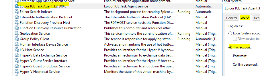

I typically don’t run the Agent as NT AUTHORITY\SYSTEM - if you do use SSO, perhaps you need to specify a proper User Account in services.msc
Just a random Service to show where to set a proper Domain User Account:

You need to set a username on the service in the console as highlighted above (Services.msc). If you need to know which username, look in Epicor for your “print” or “task agent” user - the windows login name that you need is the “Domain User ID”.
I had, thanks Calvin
Thank you SO much, this has now been fixed by setting the logon user on the task agent service in service
