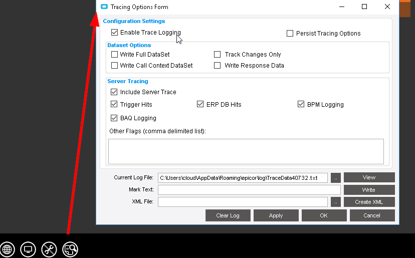

If you run a trace it should show you. As I recall, it was “CustShipEntry” but dont trust me, trust a trace.
How i run a trace or where? You say me it was maybe
“CustShipEntry” is te value of pcCallProcess?
Also, the guide: Sign In
Thanks so much!! Now I know what is the parameter :smile:
