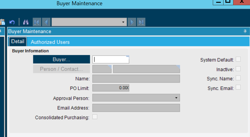

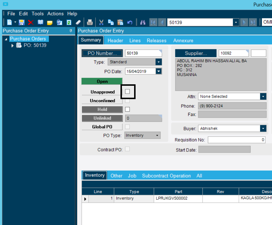

Dear experts, How to set purchase order status Pending on Unapprove Checkbox selected, When no Buyer limit & Approval Person has been set in “Buyer Maintenance”.
write a BPM on Change Approve switch Pre-Processing checking the above conditions

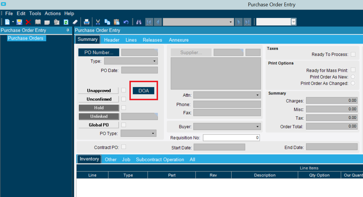

We have added the custom button DOA in PO screen refer to below screen
on button click , By default set the PO status “Pending”
