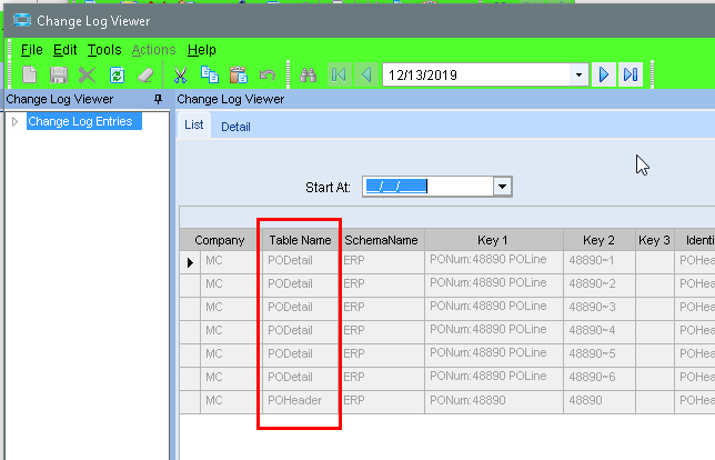

So on the Change Log window you see all three tables listed?
(We only track Header and Detail changes)

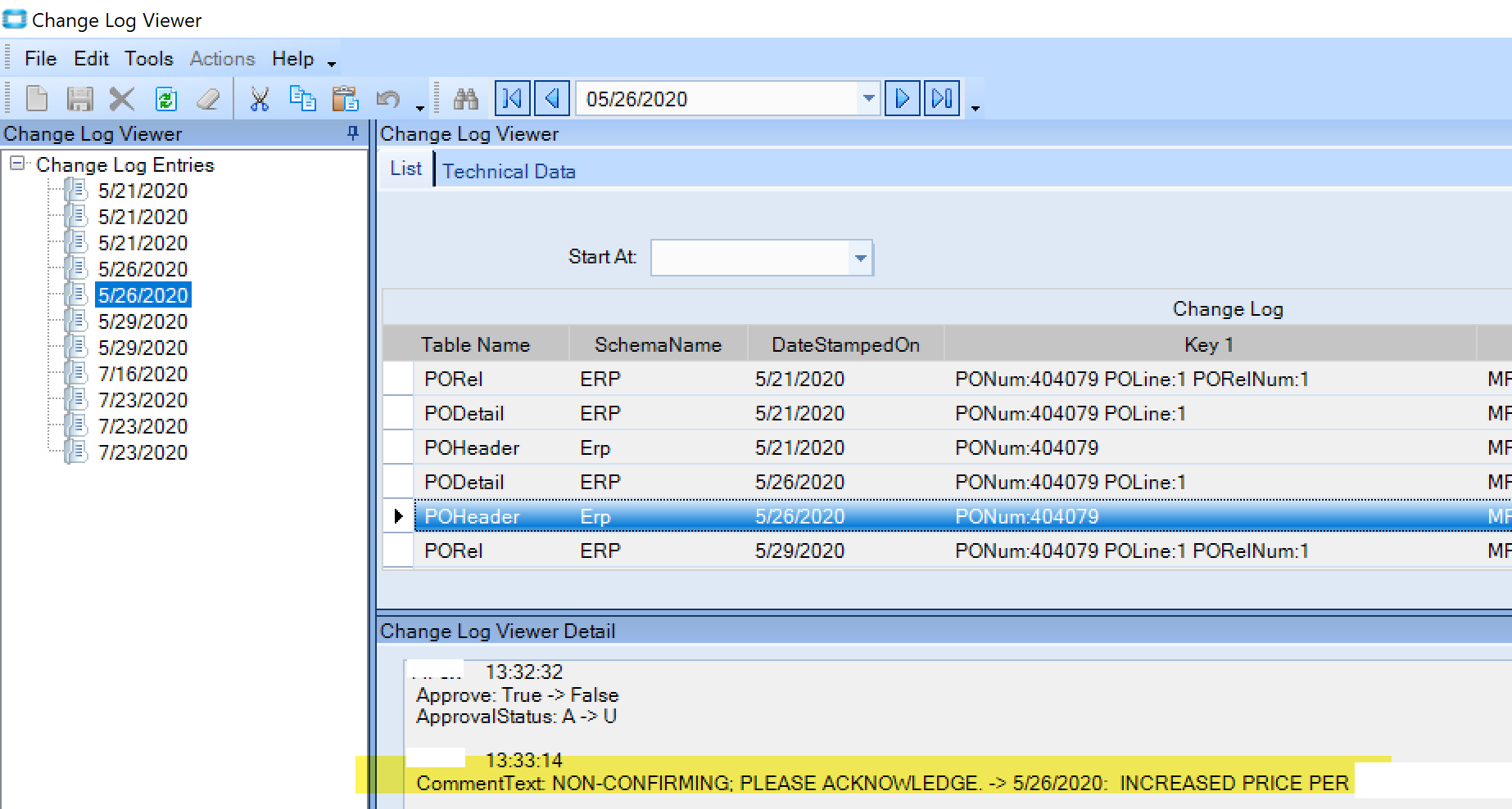

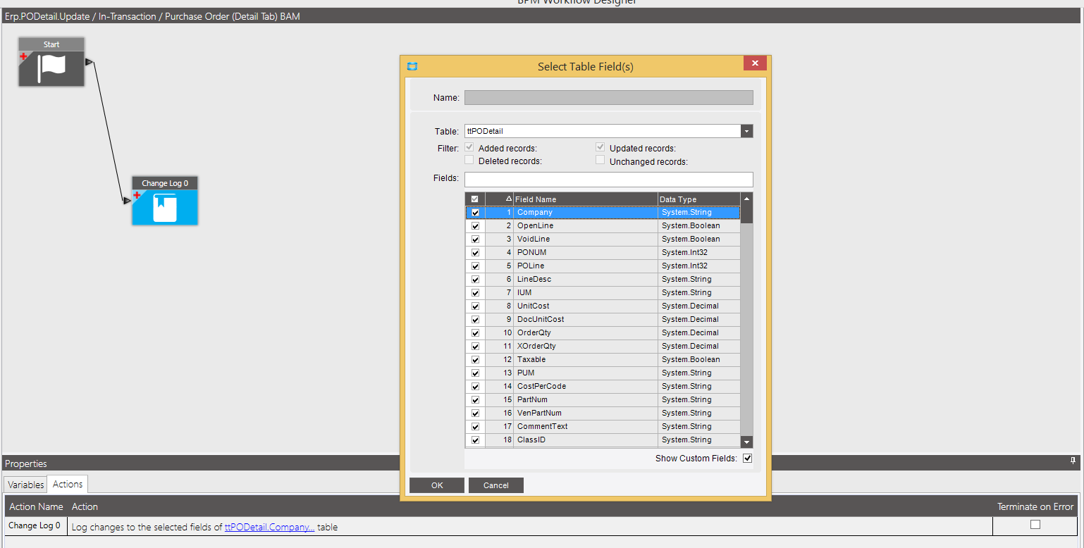

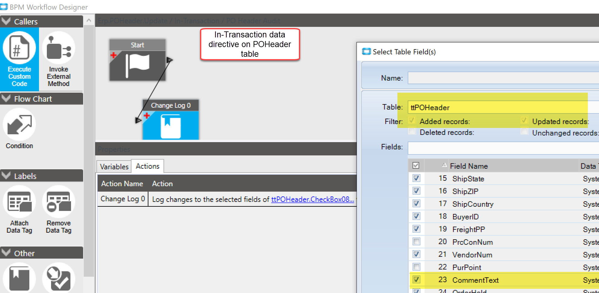

Hi Rich,
We have changelog tracking on PO comments fields, per example below. I wonder if you have something wrong in your data directive. Are you using an in-transaction data directive on the tables? The field is called Comment text in both the POHeader and PODetail data.

Sorry it has take n so long to get back to you. This did help me. I had it set the way you mentioned, but since it was a BAM, that did not convert from Vantage 8 it did not work. I deleted it and redid it and it works. The other thing I did , I forgot to enable the the BPM when I was done.
