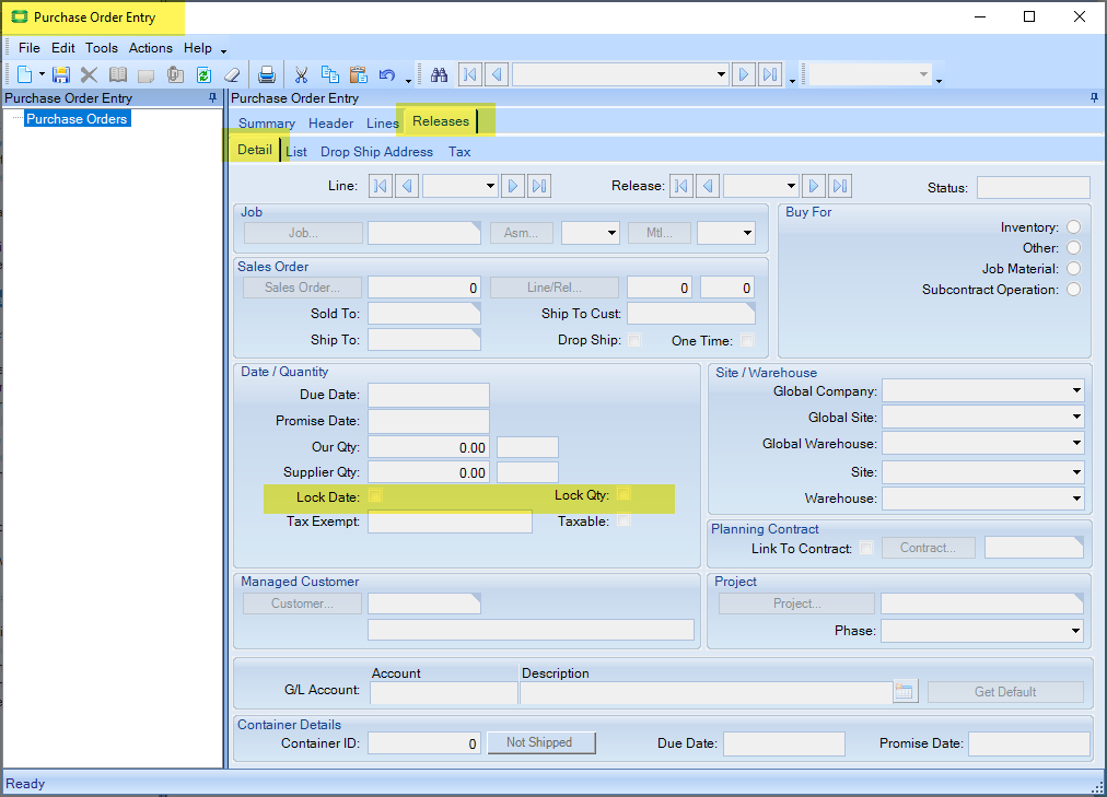

In some cases we find it useful to lock PO release date and quantity to eliminate suggestions to change a PO we know we will not change. Maybe you can test this and see if it is helpful. Beware however if you need something immediately (e.g., to fulfill SS…Epicor wants it right away) or sooner than current PO is going to get there, you might get a suggestion to create a New PO to cover the more immediate demand.

How do you “lock” the PO release date? This might be helpful for us but I don’t see where you do that
Gotcha! Thanks for this. I will definitely give this a try to see if it helps with creating less suggestions
