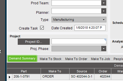

Are you using the Default Planning Contract at the Project Level? I am trying to link an existing project with Planning Contracts. The Project was tied to an order and had empty jobs created to it to satisfy the demand. I have severed the links and have created the Contract Bins , but I can no longer link the jobs back to the order. The error I am getting is that the Project is tied to a different Planning Contract. When I check the Project the Default Planning Contract is grayed out though…

For the jobs and the links, remove the demand link from the job, then set the contract, then re-add the demand link. The order needs to have the same contract linked to it as well or you get that error.

with a quick test, the contract get grayed out if there is a job connected, but as soon as I remove that connection, it opens up again. Did you remove all job links to the project? (not demand links, the project ID in the job)
