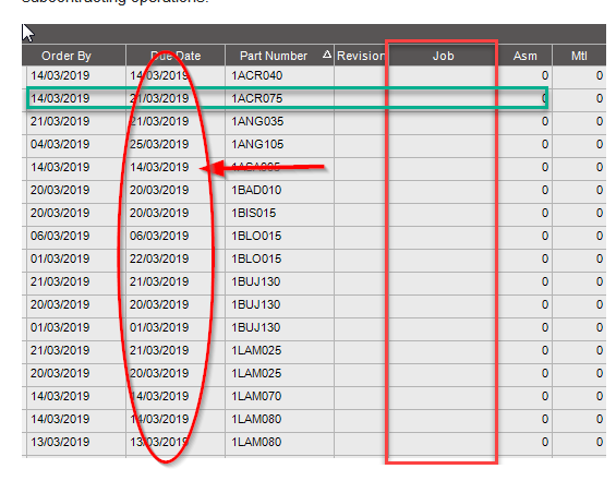

Link a Job whit a Purchase Order
We try to make the suggestions of purchase orders appear for what work they are, we have not been able to link the suggestions that result from running the processes to generate suggestions and show what work is required, the work field appears blank.
Does anyone know How to link the material that is needed for a job with the suggestions of purchase orders?

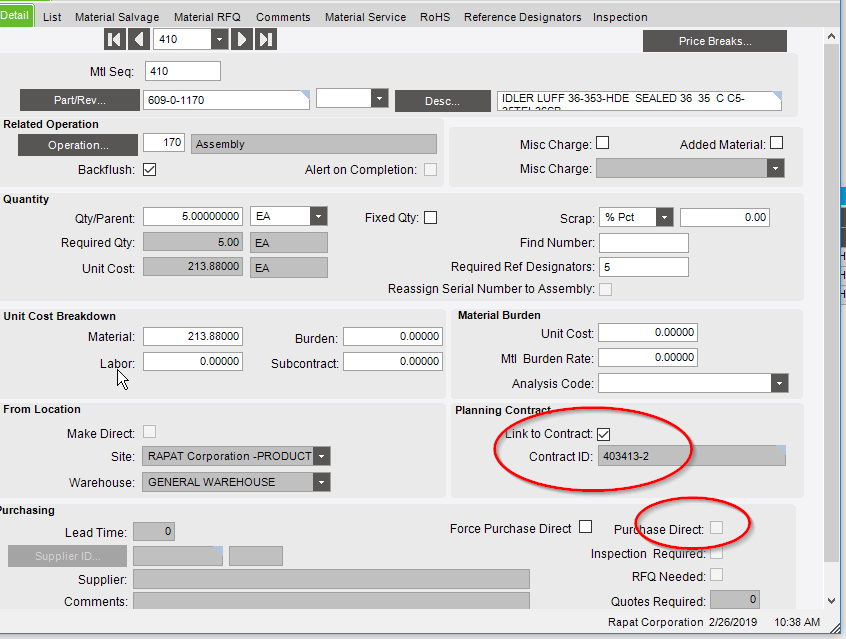

You can make the materials on the job purchase direct, but that means you have to have a release for every place on the job that it’s used, (may or may not be a problem depending on your BOMs). Also when anything is received it gets issued directly to the job, bypassing inventory. This has some costing implications to be aware of.
The other solution that we use, is to make a planning contract for each job. This basically makes a mini-warehouse just for that job for parts that are designated link contract.
Those are two ways to be able to know what materials go to what job.

There is a lot going on with each of those, and a lot of set up to make it work on it’s own. But once you get it set up the correct way, it will pretty much work on it’s own.
Here’s a long thread where I learn about how planning contracts work. It should give you a basic understanding of how they work and what it takes to set them up.

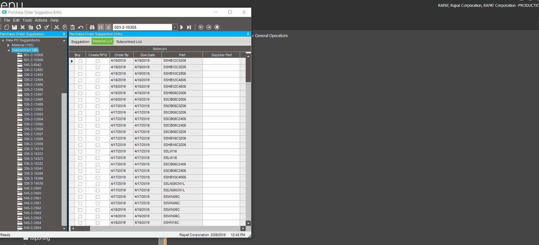

@ckrusen Some material is in inventory, but other material is purchased specifically for the job. When running the process of generating suggestions, the material that is thrown does not show what work is required, the work column is blank, the only suggestions they bring for which work is required are all subcontracting operations.

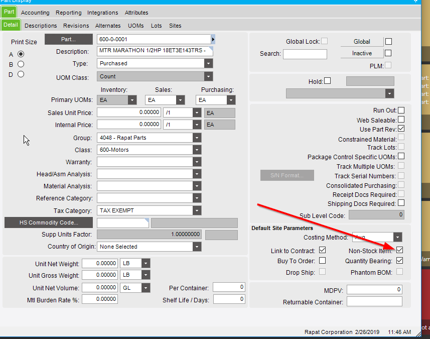

If you have parts that you will almost never buy to inventory, check the non-stock check box in the part maintenance. This will trigger the system to select purchase direct when the job details are built. Then you will get a suggestion specific to the job.
follow-up to @Banderson’s post… A part that is Non-Stock can be stocked. A better name would be, “A part we’d prefer not to stock, but are willing to.”
If a job need 75 connectors, but they come in boxes of 100, the leftover 25 could be put into stock for later use. Otherwise you’d have to expense the hole box of 100 to the job and “throw out” the leftovers.
Just don’t forget, you will have to manage those extra 25 mostly manually. That part will always create the buy to job suggestion, but you can change it once the job is built. You just have to remember to look for it. (that can be kind of pain)

The non-stock makes it so it doesn’t care what’s on hand. Someone has to look and make the decision to uncheck the purchase direct box.

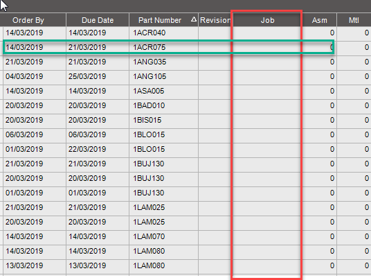

@Banderson We want you to show the work to have a quicker way to check if the material you are suggesting is ok. To be able to filter by work and do a faster search.
The Non-Stock Item field is selected only for the final parts that are manufactured here in the company and are those that are sent to customers. We do not select the material that is purchased because it may contain material or pieces and these are left as stock in storage.

@Banderson That is one of the reasons why we are interested in the purchase suggestions we can see the work for which they are required, some jobs require the same part. If we want to find for which job that part number is required it would be quicker and easier to see it from the suggestion than to track the part or where it is used.
It is correct that Epicor is supposed to order it by date and by priority depending on the programming.
It’s pretty easy to use the time phase to walk through the list. It’s just right click, open with, and then as you click on different part numbers, the screen looks up whatever row you are on. If that isn’t good enough, you will need to buy direct to the job (non-stock). There is no other way to get the job’s required into the purchase suggestions, because a purchase suggestion to a job is not a 1:1 relationship.
