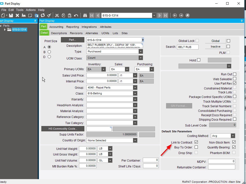

If the part is set as link to contract in the part entry screen, when it’s added to a job with a contract assigned to it, it will automatically be linked to the contract. The PO suggestion comes through as demand to buy to that contract for things that weren’t added ahead of time. We don’t use MRP, so I don’t know how that will throw a wrench it though. When you have a make to order job, and the order has the planning contract created, the job that’s created will have the same planning contract assigned. Then whenever details are brought in on that job, non-stock parts that are selected link to contract, will be linked, and the demand shows up on the contract. Anything with a PO or inventory already received to the contract bin will satisfy that demand, and there won’t be a suggestion for it.
