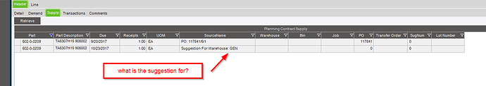

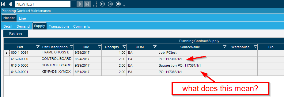

Does anyone out there know what this means? I have a PO out there for the two that are required linked to the contract. It shows in the supply. What’s with the line that says suggestion PO? I can’t find any more information about it. (I will admit, I am notoriously bad a finding help information without guidance though).
and while I asking about weird things in planning contracts, why does a cancel PO line show up in the demand for PO contacts? If the purpose of PO contracts is to hold supply until the demand shows up, how could it know to cancel a line?

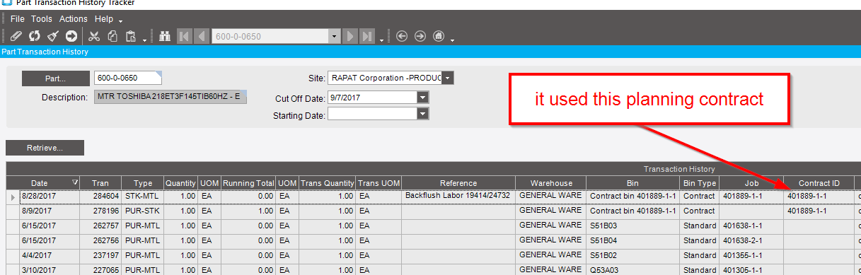

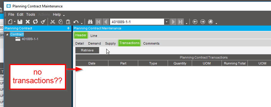

I can’t say for sure on this specific order, but other planning contracts do.
I’m suspecting that it has to do with the linked objects being closed, since this is the first one that we have used that everything being purchased, and issued to is now closed.
I’m still waiting back to hear what service has to say about this.

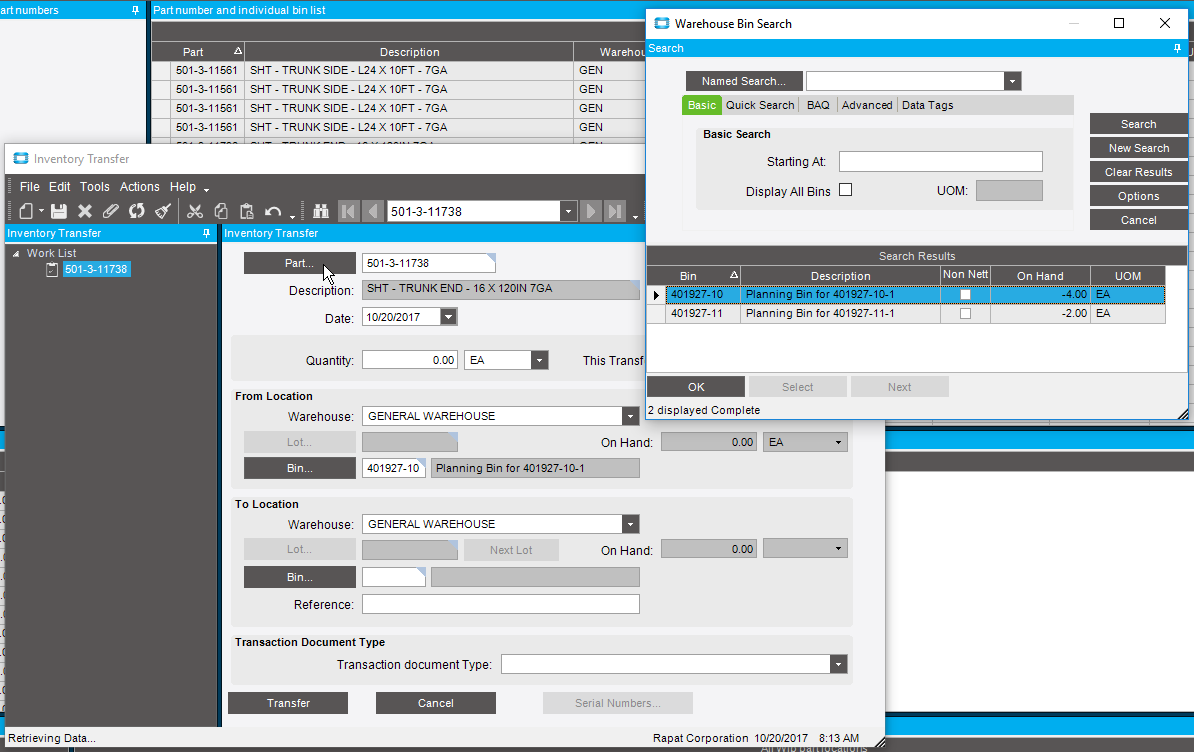

To add more to the saga. There is “as designed feature” in that the inventory transfer screen shows 0 on hand in a contract bin. I thought it was a simple bug, it got submitted to dev, rejected, submitted to dev again, rejected again, then told that I’m not supposed to use the inventory transfer screen to move anything into or out of the bins, and that I should hire a consultant to tell me how to use planning contract.
So my question is, if I’m not supposed to use inventory transfer, how to do get parts into contract bins when I’m not purely buying to the contract, (or when stuff got incorrectly received)?
I am being kind of facetious because of the screen works fine to move inventory in and out, and I’m pretty sure when I took the training at insights that was a procedure that was explained. I’m just wondering if someone knows something I don’t

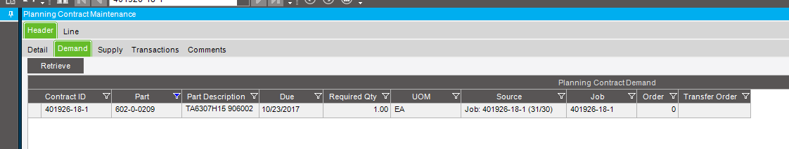

We are looking into Planning Contracts and are a little confused…
We have the demand in, generated PO, received it into STK, and now we created a job which links to the contract id, (we now have 2 duplicate demand, 1 from PC, 1 from the job). When we backflush it, it does it from the contract bin, which is great.
My only problem is that even after the material has been backflushed, the original demand in contracts still exists.
Is this something we just have to manage manually, or is there something I am missing that can help us in Epicor.
