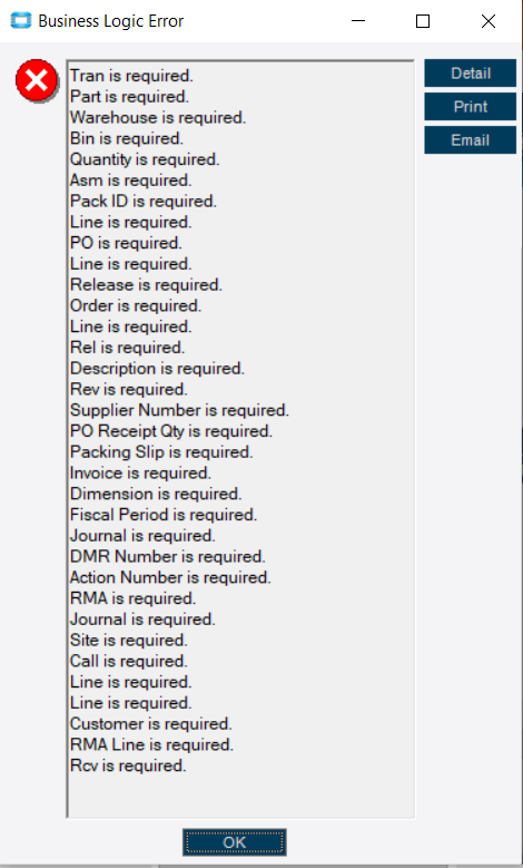

Trying to complete an inventory transaction using C#, but running into walls. When I run the code, I get this error:
I went back through my code and added all those fields in with values that mimic a similar Qty Adjust transaction made through the form. I still get the error. Has anyone made this work before? Code below:

You are better off turning on client tracing, doing the transaction in the erp and then compare the dataset being sent to the Update to yours.
Please do yourself a favor and do a Trace then follow the trace to a T
You are using the wrong business object, you can’t write directly to PartTran
Like @Jonathan said, do a trace and start there, doing a direct Part Tran write like you are attempting is going to cause all sorts of pain and suffering (if you even get it to work).
I started that route, and I ended up with that BO just from digging around.
I am used to a “GetNew…” sort of object, which I couldn’t find. I started out with trying GetInventoryQtyAdj(), but it isn’t actually returning any data. This was the original trace that I was trying to follow, but that is where I stalled.

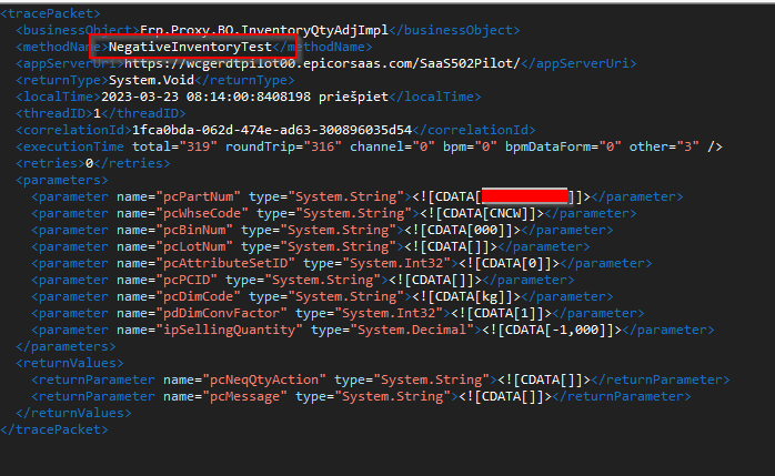

  <threadID>1</threadID>
  <executionTime total="538" roundTrip="527" channel="0" bpm="0" other="11" />
  <retries>0</retries>
  <parameters>
    <parameter name="ds" type="Erp.BO.InventoryQtyAdjDataSet">
      <InventoryQtyAdjDataSet xmlns="http://www.epicor.com/Ice/300/BO/InventoryQtyAdj/InventoryQtyAdj" />
    </parameter>
    <parameter name="partTranPKs" type="System.String"><![CDATA[]]></parameter>
  </parameters>
</tracePacket>
You don’t need to do GetNew since you aren’t creating anything new you are reducing qty onhand.
Follow that trace the first call returns a Qty adjustment dataset and then you use that to do the rest
Okay. Let me give that a shot. In my mind I had that I had to create a new record versus modify what exists, so I think that is why I got lost. I will give this a shot!

Hi,
Do I understood correctly, by this you are skiping NegativeInventoryTest is this ok to skip this method?
Depends entirely on your business process. In that example I had probably just checked the quantity above to ensure it was valid, before processing it.
Good practice is to follow all of the same calls that Epicor makes, unless you have a good reason not to and understand the process fully.
