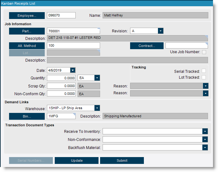

Or use Kanban Receipts. This would be less steps than Quick Job Entry.
You could set up Alternate Methods if the quantity is not always 5 or different parts are cut.
You can try Kanban for the 5 parts created. All the entries will be done in one step.
